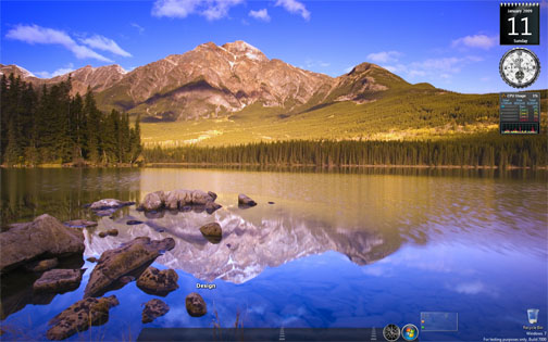

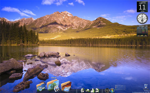

Thank you for your great docklet. Just tried objectdock 190b537u+stack docklet on 64-bit Windows 7 Beta 1 (7000.0.081212-1400) and found its working perfectly as usual. (except the icon problem off course)...
update: when we hide the dock sometimes its not able to appear by mouse movement... no its not the stack docklet fault its sure be the objectdock failure

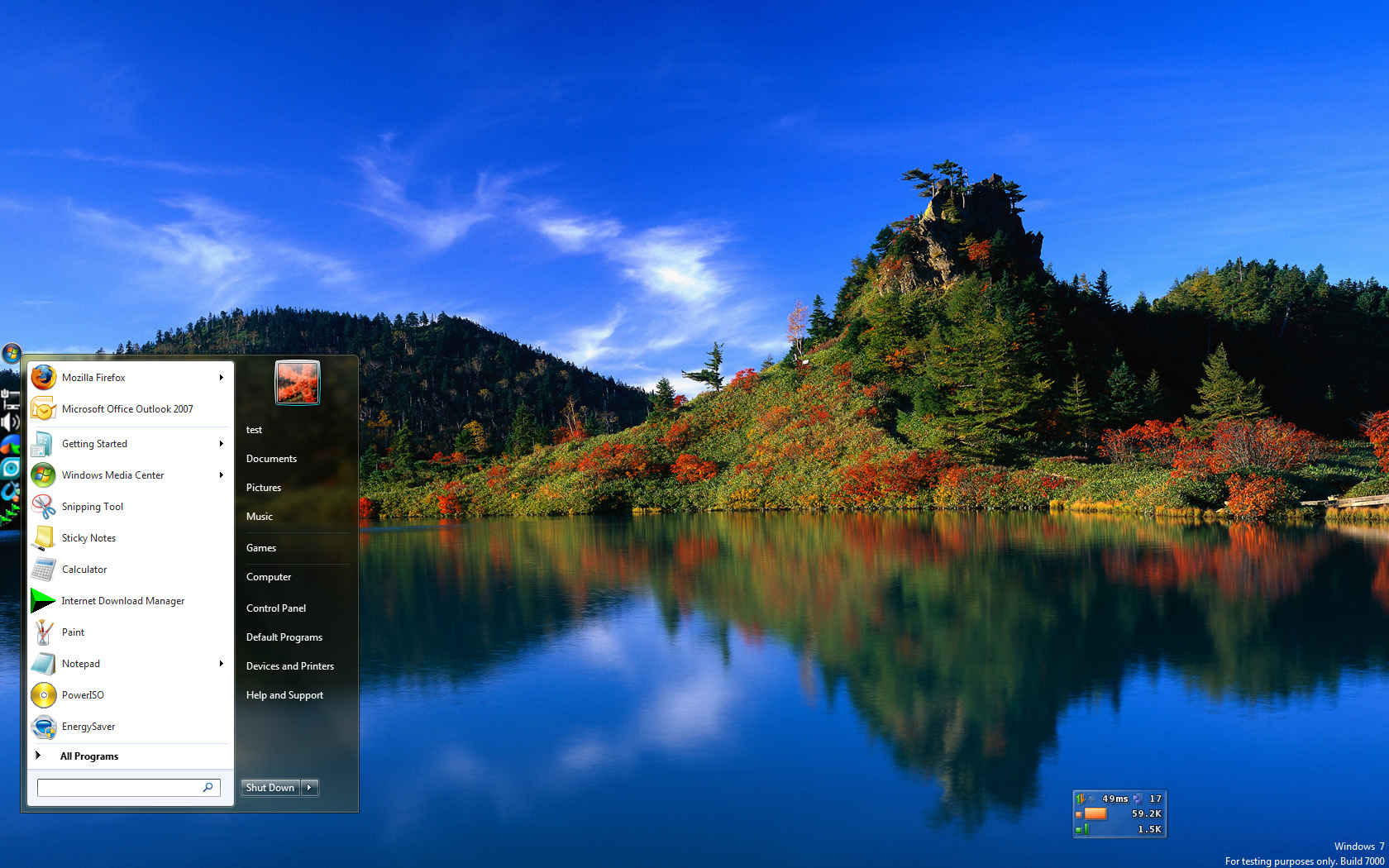

I have just installed windows 7 beta, and object dock works fine, but when i click on any of my stackdoclets to open them it crashes object dock.
Any chance of getting this working on windows 7? :)
