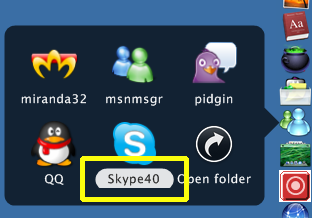

in Fan model, clicking on one item opens other program.
ps. the label in grid may need some modification
