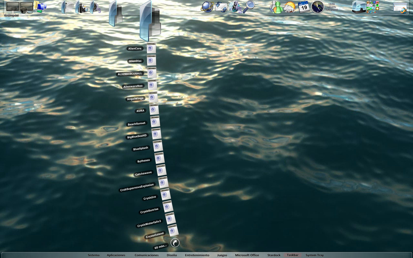

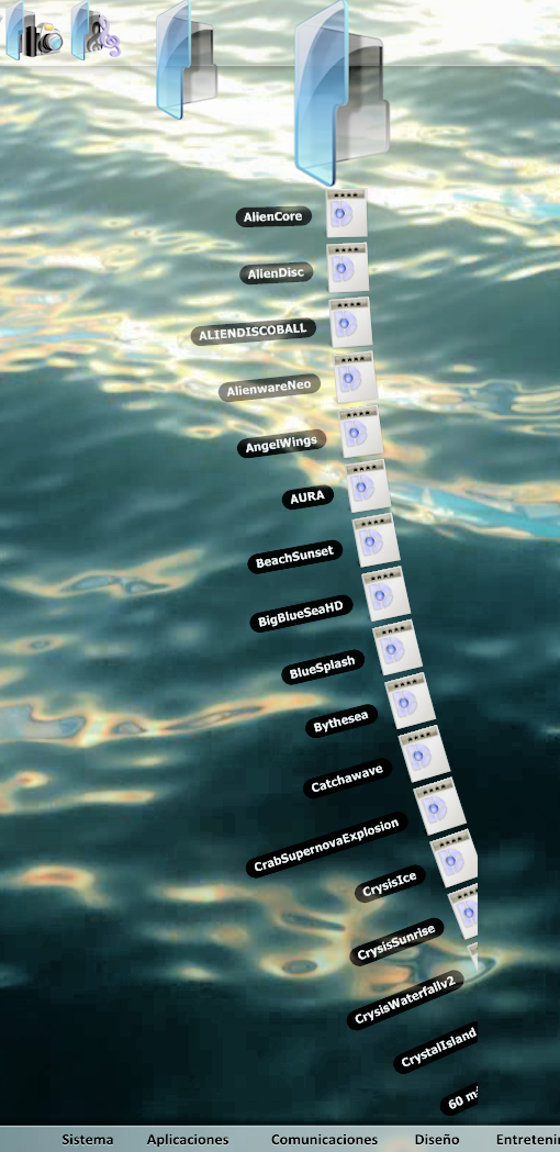

I found a little bug... if the dock is dragged after while fan mode is displayed (with "follow the dock" option enabled), then clicking on the dock icon again to hide and respawn the fan again causes it to be redrawn at a position far from the dock's icon. After hidding the fan again an respawn it, the problem goes away an the fan is show at the right position again.
Take a look at the attached image.

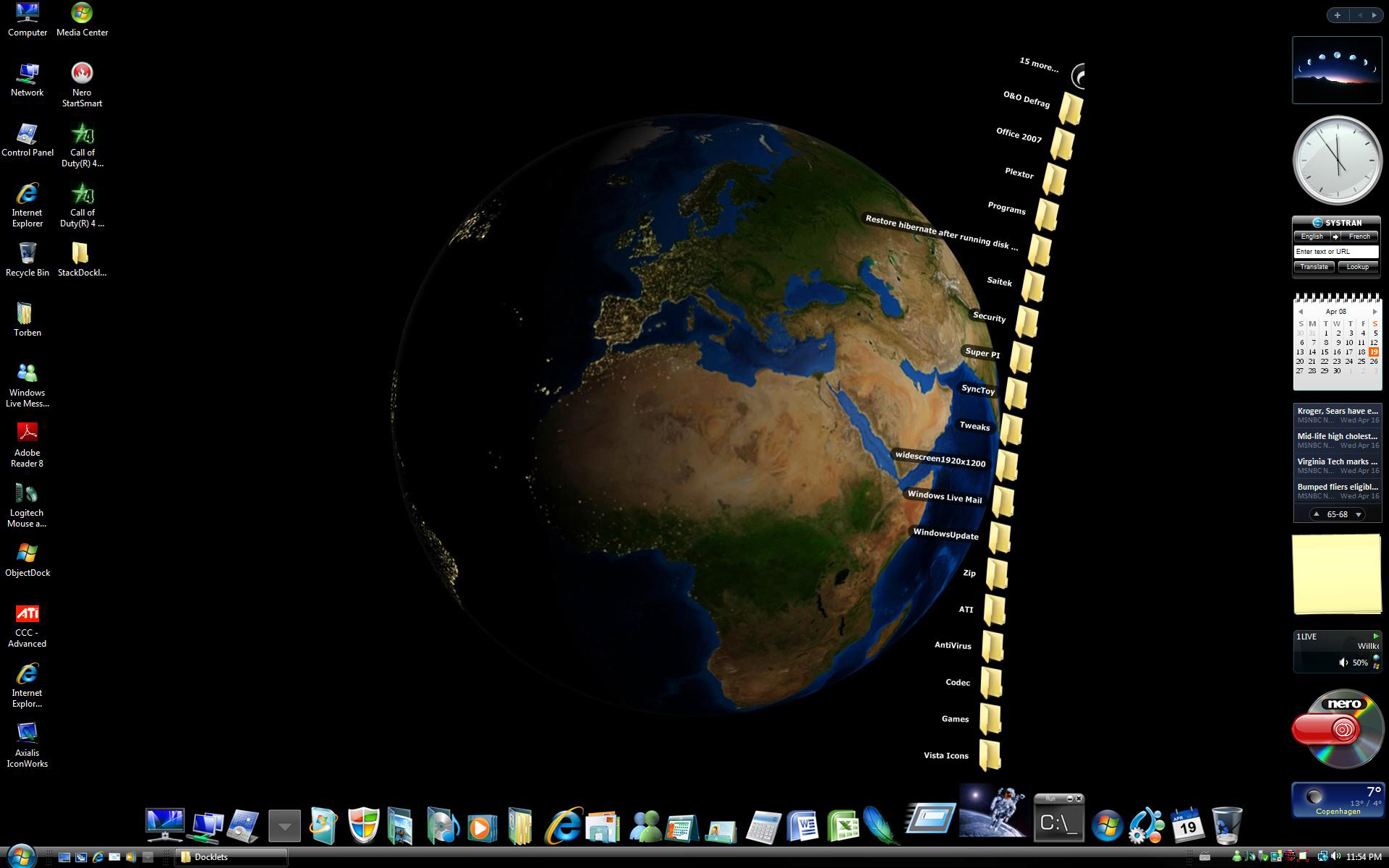

@matonga
Fan mode is still broken if you have more than 13 icons in your folder (My resolution is 1920x1200)
See picture: FanMode.jpg

Yep, same thing here...
@matonga

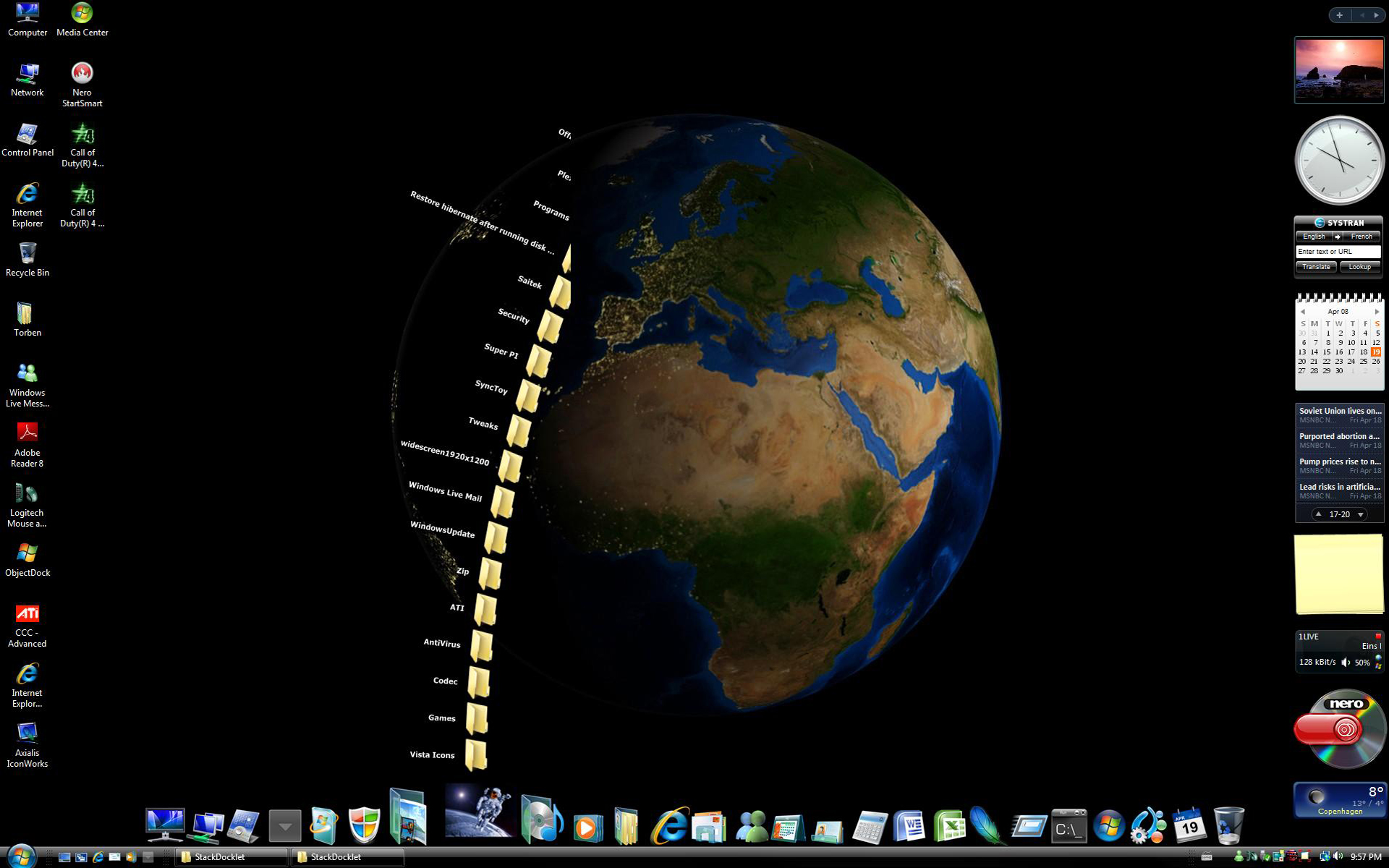

@matonga
Hi again
The fan mode is very close to be correct now (This folder has 33 folders/Icons)
It looks like the radius of the fan mode is bigger now, if it is possible, I prefer the smaller previous radius.
Regards Torben

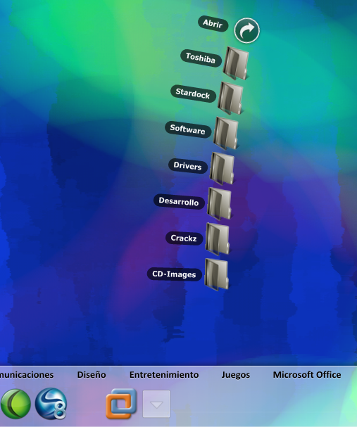

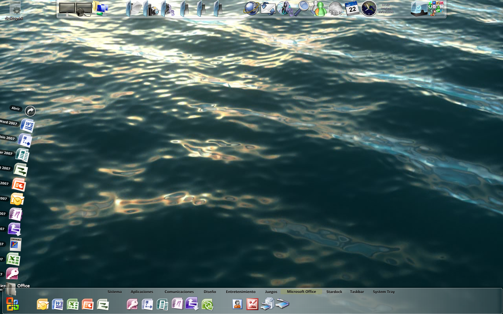

Matonga,
I found a problem with de dock when it is positioned in a dock near the left edge of the screen, the fan is shown as in the screenshot. I believe that in those cases, when the window where the icons are drawn is too close to the edge of the screen, the icon labels should be drawn to the right instead of the left. I do not own a Mac, so I am not sure how the Mac solve this issue.
