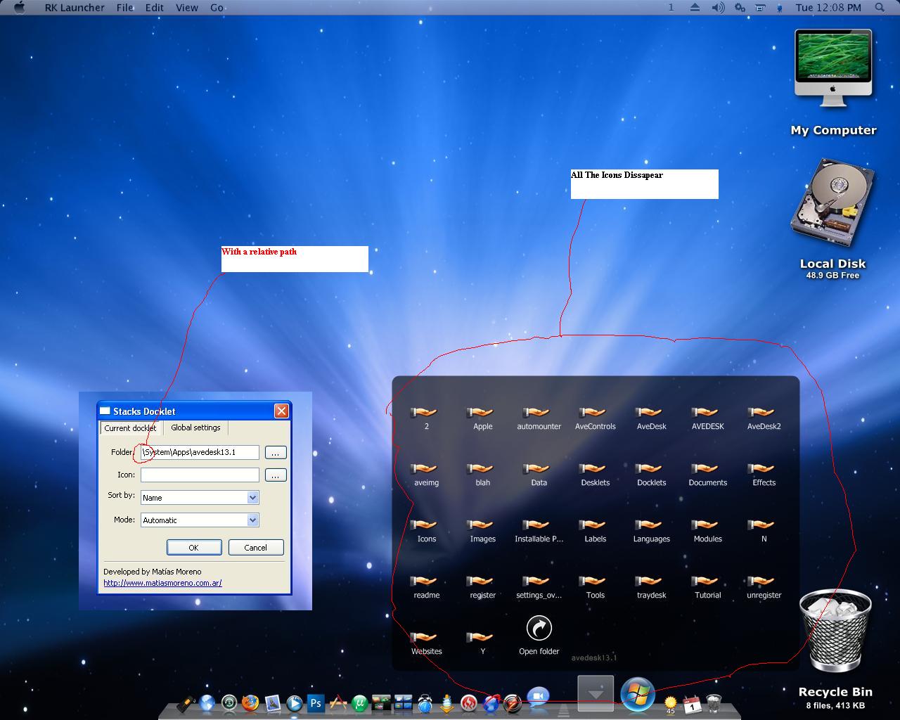

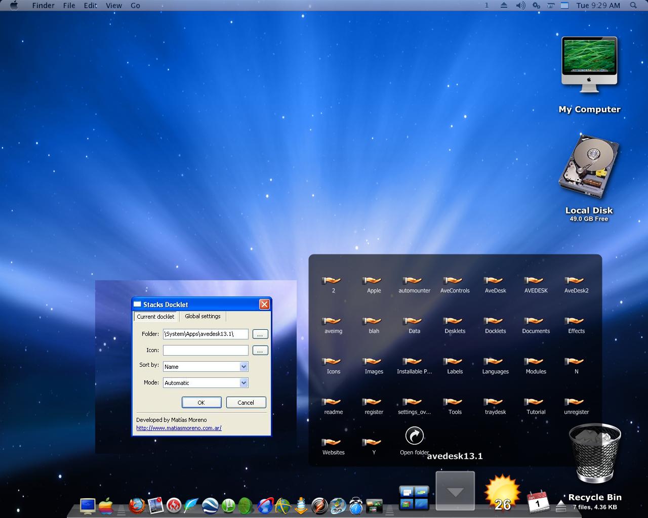

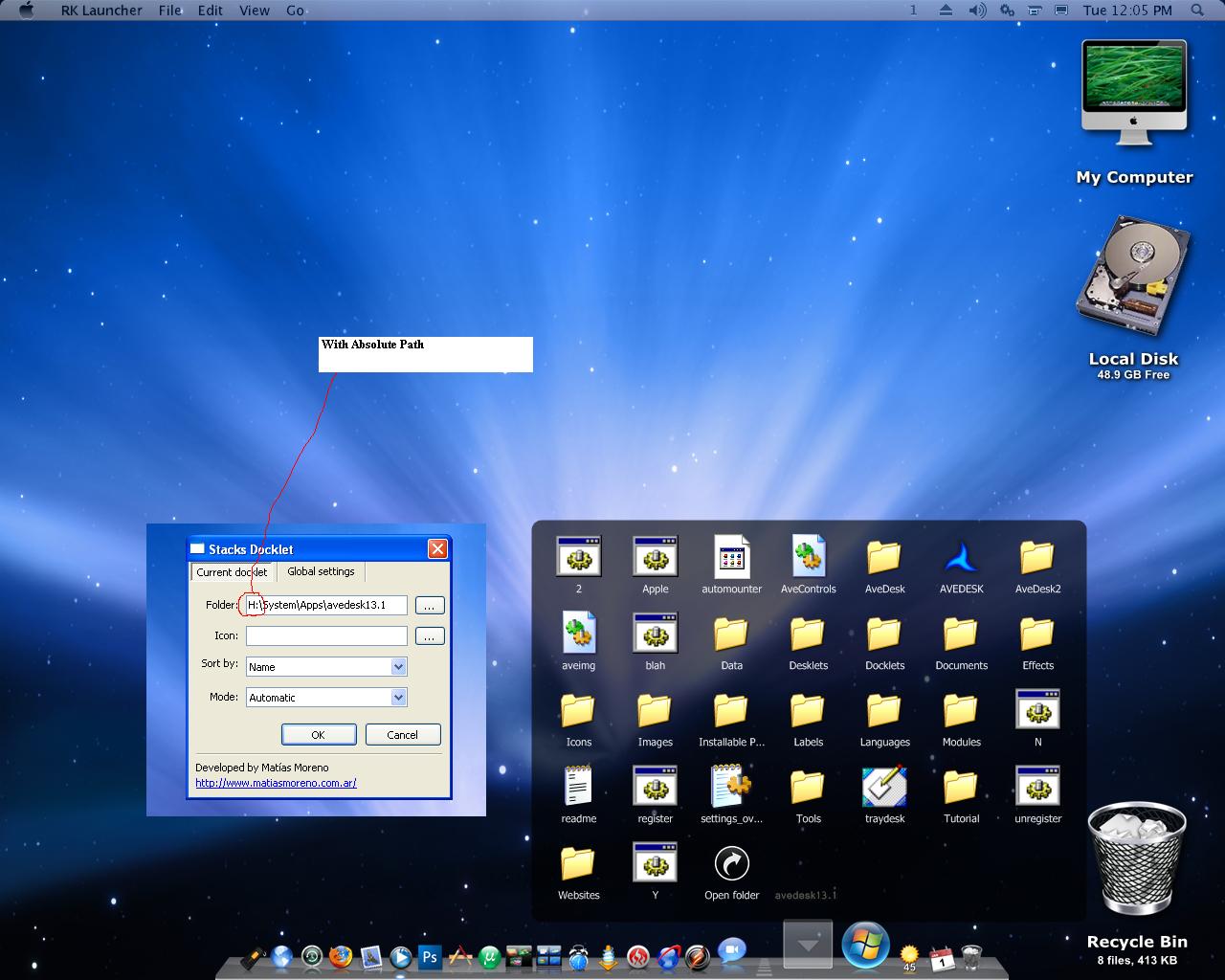

I use Rocket Dock 1.3.5 on my USB drive, so i have to use relative paths, when i use /apps/ for a relative path, the links work just fine, its just that the icons are not updated in fan or grid view. however, picture files have the correct thumbnail.
#485625
Remove the last backslash.
Edit: ok, uploaded a new version which I hope fixes this issue with last backslahes.
#485645
thanks for your quick response!! i did test the new version, and it still doesnt display icons with relative paths, eg. instead of f:apps i would use apps because the drive letter changes depending on what computer the usb drive is in, the links work fine and i also tested it in rklauncher and same problem with icons not displaying.

Okay. the problem with the same class docklet in RK launcher has been solved (rename stack.dll to stack 2.dll procedure) but a new one has appeared then. If you open first stack and then the second one - the first one will not close automatically if you use two dlls.
