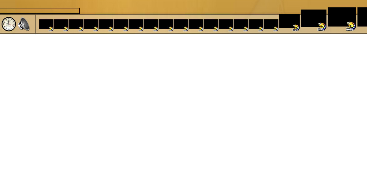

I use BulletProFTP (www.bpftp.com) and if i reduce to icon.....many..many and continue little image of this app...in Launcher: see image.
I also try to exclude this apps form config of launcher but nothing...
Plaese tell me advise
Thanl
Paul
#323896
did you exclude it from the minimize exclusion as well?

Yes...Thank
