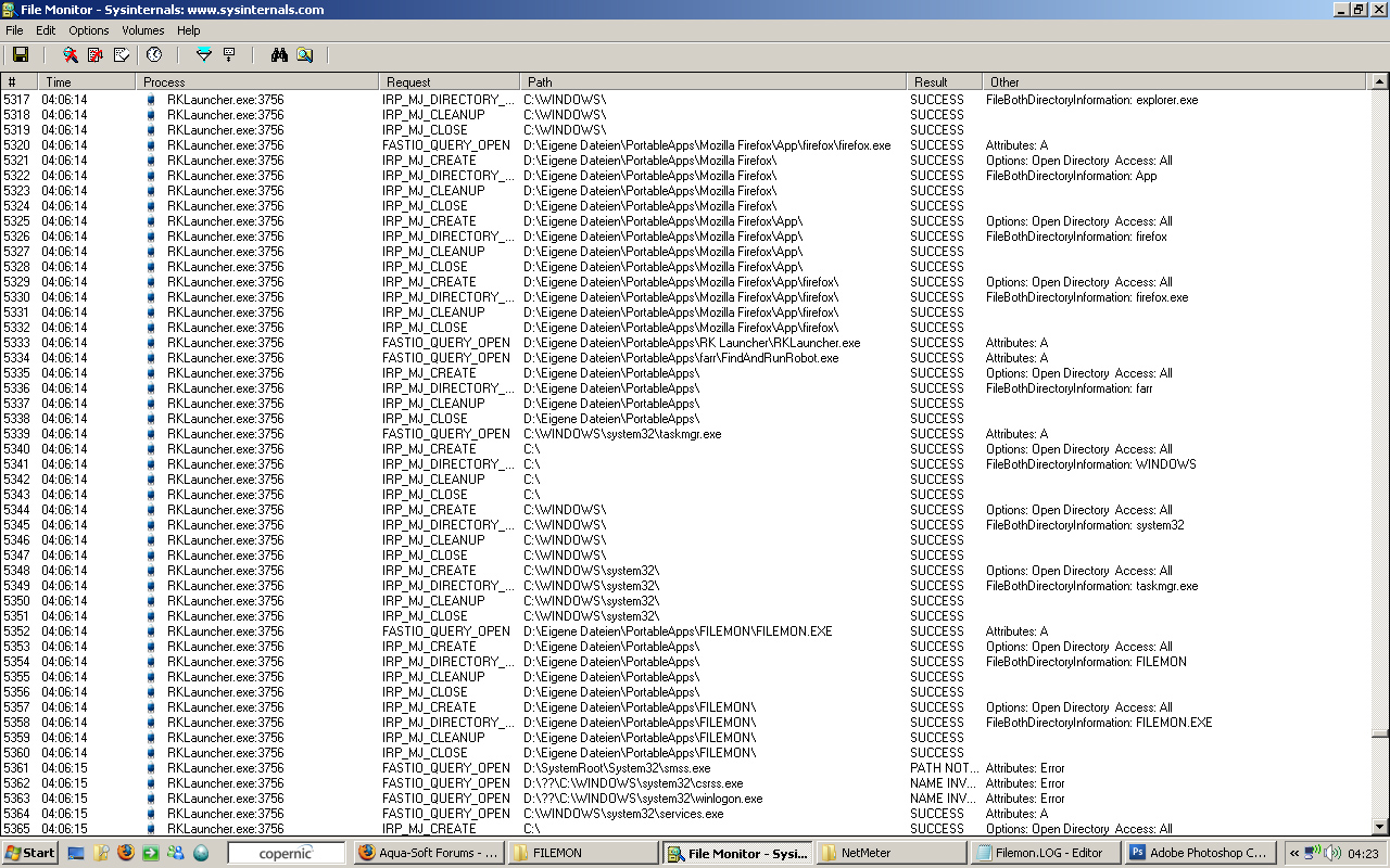

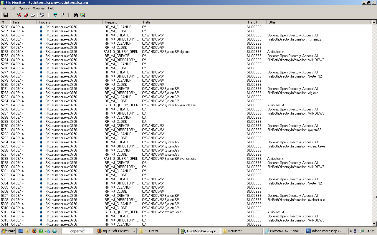

Hi, I've found an important issue! I was wondering, why my notebook was always accessing the hard drive, even if i do nothing. And because my notebook-batteries go faster empty, I took a closer lock with DriveMon. Of course, there was this and that, but i was shocked by the access from RKLauncher. I use NO docklets. Just folder shortcuts. But RKLauncher keeps accessing files like in the attached screenshots.
Its accessing all running programs and even some strange thinks like alg.exe (MS Firewall)...
And CONSTANTLY. Every 0.7 seconds it runs through these files. Again and again....
I think, this could be caused by the feature to minimize the programs to RK, or the "Running Indicator". It would make sense, if its needed to check the running tasks.

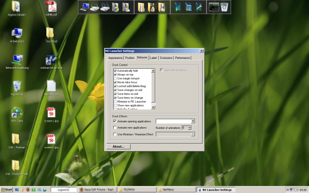

But I simply don't use such features. Screen3.jpg show my config on behavior.
I think this is a major issue, especially for notebook users. It would be very nice, if someone can found a solution.
btw, can you see the same issue in DiskMon with your RK Launcher?
Thanks, Atreiju
