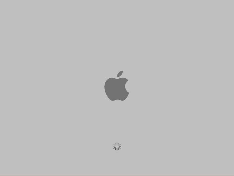

Install done. Took about 4 hours total for download, install, setup, and finishing all that up.
click for obligatory screenshot

if anyone wants to know how to disable the text that i thought originally was an error message (it isn't) just remove the -v in machargs. here's a screenshot of it booting without -v.
