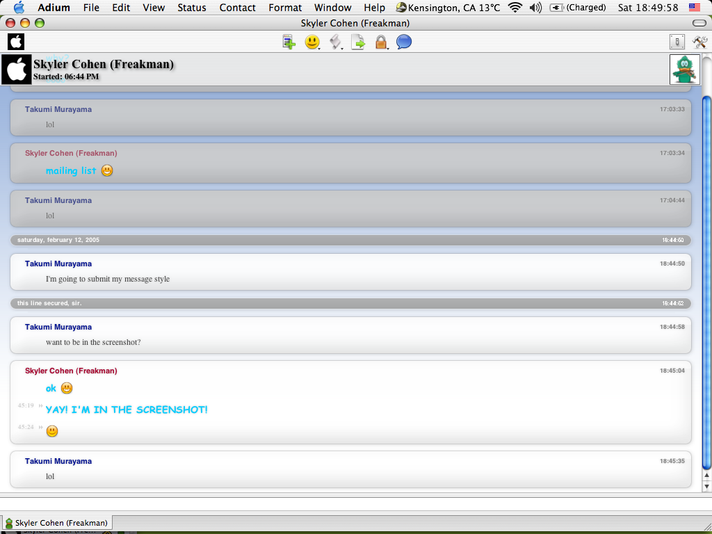

then after i started trying to see if i could do the header things with the avatar only in the top bar along with incoming name and conversation start time. refer to this image for what i'm trying to do
all the visual parts of it is done, i only need to be able to get the incoming avatar, incoming name and conversation start time to show up there...the javascript i tried was unsuccessful

its a pitty we can't use the Gecko engine from Mozilla/Firefox... CSS2, PNGs, and more... oh well maybe some other year ;)
that looks nice russelc :D are the grey bubbles from the previous convo?

i think someone asked about that on the miranda forums. they dont want to use the gecko engine because it uses more resources and would be alot more difficult to code in. it makes sense that the gecko engine uses more resources as its not built into the OS.
the grey bubbles are historical messages :) (from previous conversations, yes)
what i did is just a mod of my already released smooth operator port (shown in screenshot). the screenshot is originally the smooth operator template (on adiumx) and modded by someone else to have that bar and a smooth scrolling feature (don't ask me for it) heh.
