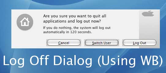

PICTURE 1: LOGOFF DIALOG
- as you can see, this is just a version of your logoff and KoL's Windowblinds one... it's distorted, buttons are different font, etc.

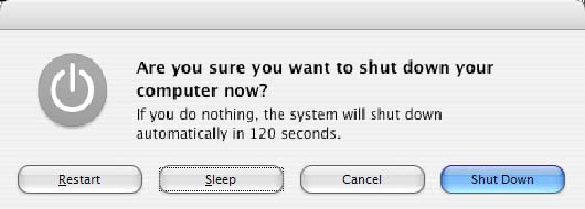

PICTURE 2: SHUTDOWN DIALOG
- this one is basically just Kol's shutdown, but stretched and shortened like the dialog you included. Different font too. As well, I am unable to access hibernate when I press shift and click on sleep.

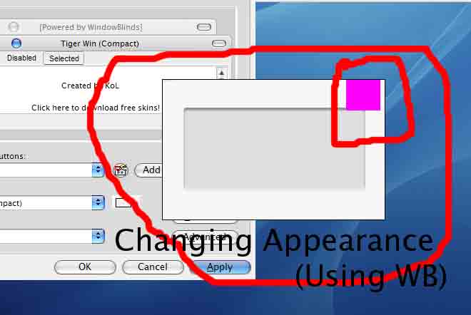

PICTURE 3: CHANGING APPEARANCE DIALOG
- This one is Kol's and hasnt been really altered by your dialog for this, however, a weird pink square appears at the top right of the dialog.

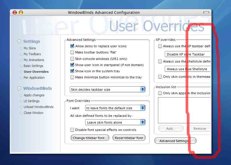

PICTURE 4: WINDOWBLINDS MENU
- there are many menus like this (in the Windowblinds control panel and other dialogs), however, this is the most apparent example. I'm finding a lot of the text etc in dialogs does not fit the dialog box properly. Instead, it just goes off to the side where I can't access it.

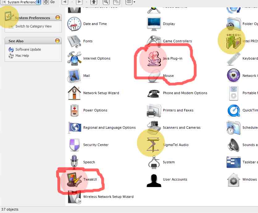

PICTURE 5: CONTROL PANEL
- The icons marked red are the ones I'm pretty sure didn't change by Flyakite SP2. I've tried reinstalling the pack (only the .cpl icons) and rebuilding the icon cache using TweakUI, but it hasn't worked. The yellow icons are ones outside of Flyakite that I have a question about. Does anyone know where the .cpl icons for SigmaTel Audio and Intel ProSet are or how to hack them? Also, the Control Panel icon on the top left that is the same as the WinXP one, is that supposed to be changed or is it supposed to be like that? The ones in my Pictures, My Music, etc, are like this as well. They remain like that despite the theme I use too I think.

1,2, and 4 are all due to the same reason: The "Mac Shell Dialogs" font. While it's a cool registry tweak, it forces the system to use the Lucida Grande font for shell dialogs, and due to it's properties XP has to resize dialogs, buttons, controls etc. to make the font work properly. The easiest solution is to run the uninstaller and uninstall the "Mac Shell Dialogs" tweak.
3. Honestly I'm not sure as to the real reason this is happening, but it MAY be due to WindowBlinds. Turn off WindowBlinds and use a visual style. Then change the visual style and when that image pops up, see if it still has the pink.
5. Java didn't change because you don't have the newest version, 1.5 (or listed as 5.0 on the site). TweakUI didn't change either because you didn't install the EXE files, or you don't have TweakUI installed in the system32 directory, or your icon cache needs rebuilt, or you don't have the same version TweakUI as I do. Intel ProSet and the sound icons didn't change because those icons aren't included in my installer.
If anyone ever has odd control panel icons like the Intel ProSet or weird Audio ones, contact me, or send me the file that icon is in to my e-mail, as well as where the file is located, and it can be included in a future update or release.

1. Addressed in the post above this and in the FAQ, but for argument's sake: It's due to the "Mac Shell Dialogs" registry tweak. There's no way around it. So if it bothers you run the uninstaller and uninstall that tweak, then restart.
Shell font again. I had the same problem when I modded it myself.
To fix it you can use reshack to edit the wbconfig.exe and change all the "MS Sans Serif" to "MS Shell Dlg".
Works perfect. Cept I don't use WB anymore

Actually it's due to windowblinds. I had someone on MSN and we were chatting and I had him turn off WindowBlinds, even though he still had the shell font installed, and the pink was no longer there.
#222152
OOPS! sorry, i misread your post. I was referring to the window cropping, not the pink. Sorry!
