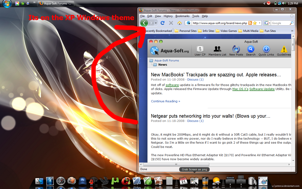

Well I've got one more :P . When I open Firefox with the dock I get the Windows XP theme for Firefox. But again if I open it normally I get the regular vista theme. Think this ones fixable?

Wow, I just figured it out.
I had been having past problems with the dock so, thinking it was vista, I ran it in compatibility mode for XP.
Thats why the aero was missing and the firefox was XP themed!
I feel stupid. :P

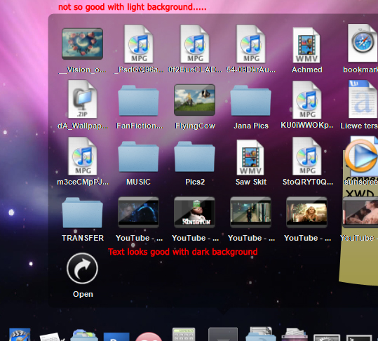

When XWindows Dock starts the screen flashes a couple of times before it stops loading. I can't explain it very well... but when you open it, the screen flashes like it's getting refreshed about 5 times. Maybe someone with the same problem can explain it better, sorry. But it's kinda annoying ;)
and I've still got the same problem of the stacks where it doesn't show some folders, I posted more about it a page or 2 back.
EDIT: Another thing :P Sorry lol but I really want to make this the best dock.
Anywho, there's something wrong with the font, I don't know if it's just me though. The text appears all "contrasted" when there's a light background behind it, but fine with a dark bg. Here's a screenshot to explain better
#516207

Your second problem is the font-rendering. The problem is, that the font-border itself can't be made semi-transparent, so the borders of the font are just a darker color, so they go better with the dark Stack-Background. But if the Stack-Background gets too light (because something white is behind id), it still doesn't look well. I guess this is very hard to change for bobah. It looks a little bit better, if you set your transparency of the stack-background to less transparent, so the background is darker all the time, even with white things behind it.
