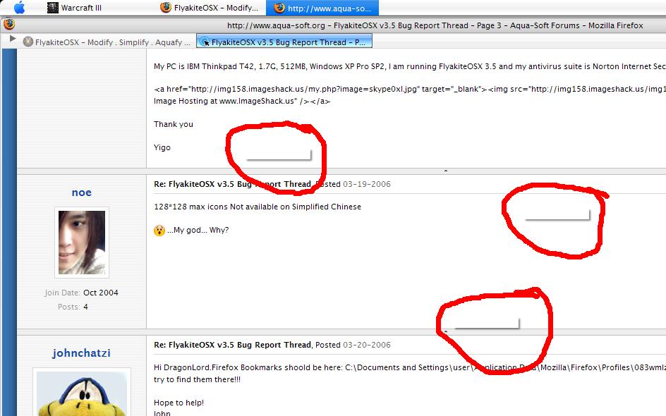

I get these Shadow Boxes on my screen sometimes. I don't know how to remove them without a restart. I have also noticed my iTunes skipping when I minimize and maximize some windows. Overall great application keep up the good work.
I have a picture of the boxes attached.
#388626
The boxes are a result of YzShadow. See if it stops if you disable YzShadow.
#388642
Disabling Y'z Shadow without a system restart does not remove them. If I restart the system they are gone. They havent came back yet but if they do I will be sure to post. Thanks for the help!

I have Y'z Shadow disabled yet a little rectangle formed. Any ideas now?
