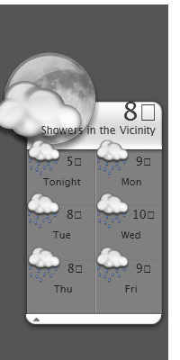

hey Tadis, I really like your work, but I have problem with my temeprature display, it suppose display C, but with square instead.
ps: My OS is windows XP+sp1a
and I've tried reinstall samurize 1.31 and reinstall your suit. but it still does the same, but the rest of scripts work perfectly though...
please help me out. I have no idea what's going on!
thanks again for your wonderful work Tadis
Gladiator
here is my screen shot.

@Gladiator
I think that appears to be a font issue?!
I know that there are different versions of Lucida Grande (as well as LucidaGrande without the space) about, so maybe you need to find the right one?
I had similar problems with a version that only displayed as bold and not regular, I dealt with it by unintalling the font through bitstream font navigator (comes packaged with coreldraw) and then reinstalling a different version.
Hope this helps
#133901
I've try couple of versions of that font, but still doesnt' work on me. now I totally lost... :blink:
Gladiator :wacko:
