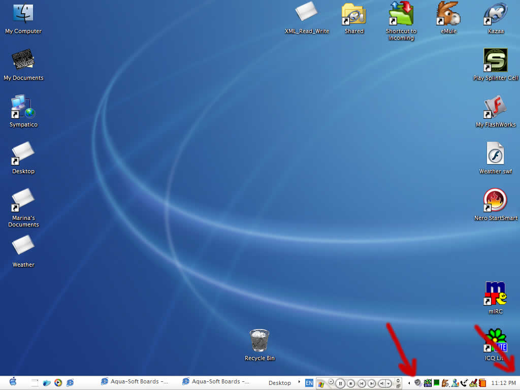

I have a problem with the taskbar, the only "nice" :D icon i see in the tray is the network connection. Is that a non replaced file problem? If yes, which one. If no, has any one, especially the M*A*N Stefanka, idea what is wrong?
P.S.
Honored to speak to such dedicated and good ppl
#120892
P.S.
stobject.dll-everyone have mod this dll by herself.

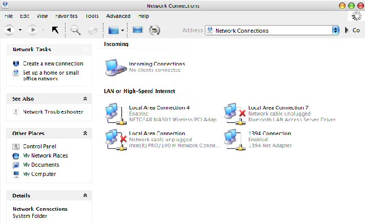

hey StefanKa........ i found this problem here..... i seem to unable to open the "properties" on my Local Area Network which is my network adapter........ which system file that you think that cause the problem? thx..... :(
#122850
the same here | i found that if you right click and select disable, `then the properties would appear.
Dont know why this is happening.
