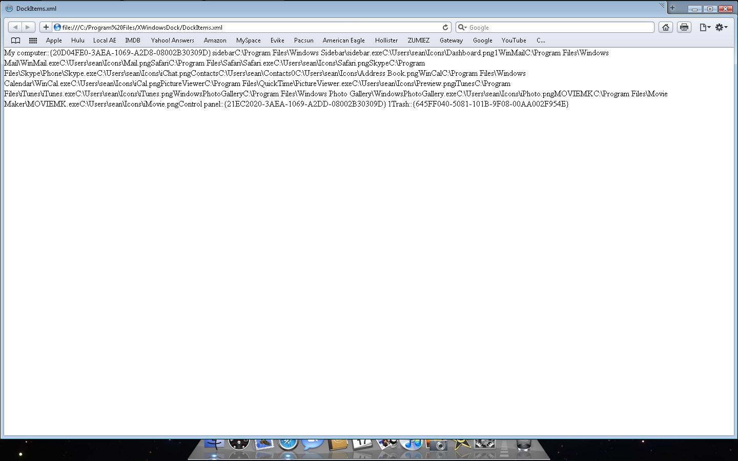

After arranging my icons on my dock, if I restart my computer, one icon or another will be replaced by another separator. If I remove the icon (separator)and restart my computer, yet another icon i have arranged will be turned to a separator. i don't know if anyone has come across this problem, but if you would like, i can post a screenshot. Thank for reviewing my problem.

Can you post/attach your DockItems.xml file?
#524553
Yes, here,

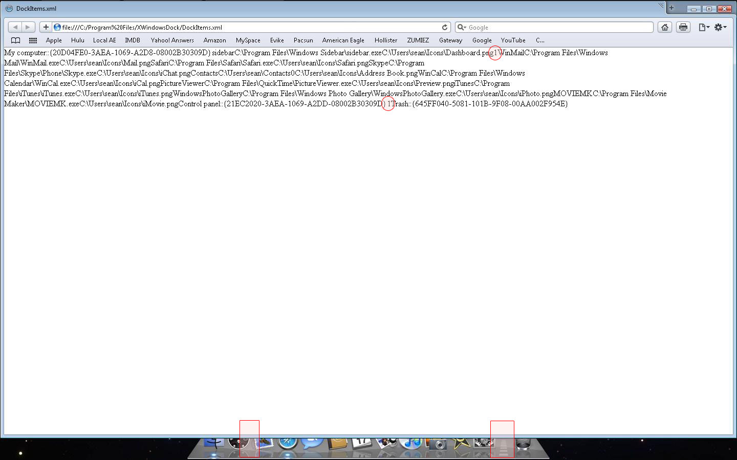

Oh there seems to be something wrong becaus I can see the dock underneath the window and according to the xml file, there should be a seperator between the dashboard icon and the mail icon.
This is my suggestion: shutdown XWD, backup your xml file, REMOVE the numbers I highlighted in the attached pic and restart XWD. Then you can try to add seperators where you want them and see what happens. Don't forget to backup because I'm not sure this will actually work.
EDIT: Ooops... I guess you guys answered while I was typing... sorry about that! I guess my solution is a convoluted way of getting around it :)

However I'm curious of one thing in the xml; there is one line with the following:
"...sean\Contacts0\C:\Users..."
Is that 0 part of the shortcut or is it something XWD uses?? I can't figure it out...
