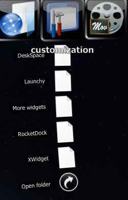

Ok someone pleaseeee explain how to fix Stack Docklet 2.0 to show icons on Win7 64bit ULTIMATE. I can configure the main icon of the stack but the icons inside the fan/grid are all the same - the docklet is not using the real icons :( Someone said he fixed it but didnt say how :(
oh my goodness...atleast SOMEONE out there has the same problem as me.lol
Ive been trying for DAYS to fix this...of course to no avail.
I want to ask...(bc i know or atleast read that stacksdocklet isnt all that compatible
with windows 7 x64)...*FOR THE DEVELOPERS* - Can stacks docklet 2 support standard ico. files?
It only seems to use the png. files for the icons and windows 7 ultimate x64 isnt compatible with png. icon files(clueless as to
why not). ive already tried converting and icon packager...nothing works.
Much like m2iceman...i just want my icons to show up when i click on my stacks docklet, instead of blank white pieces of paper.

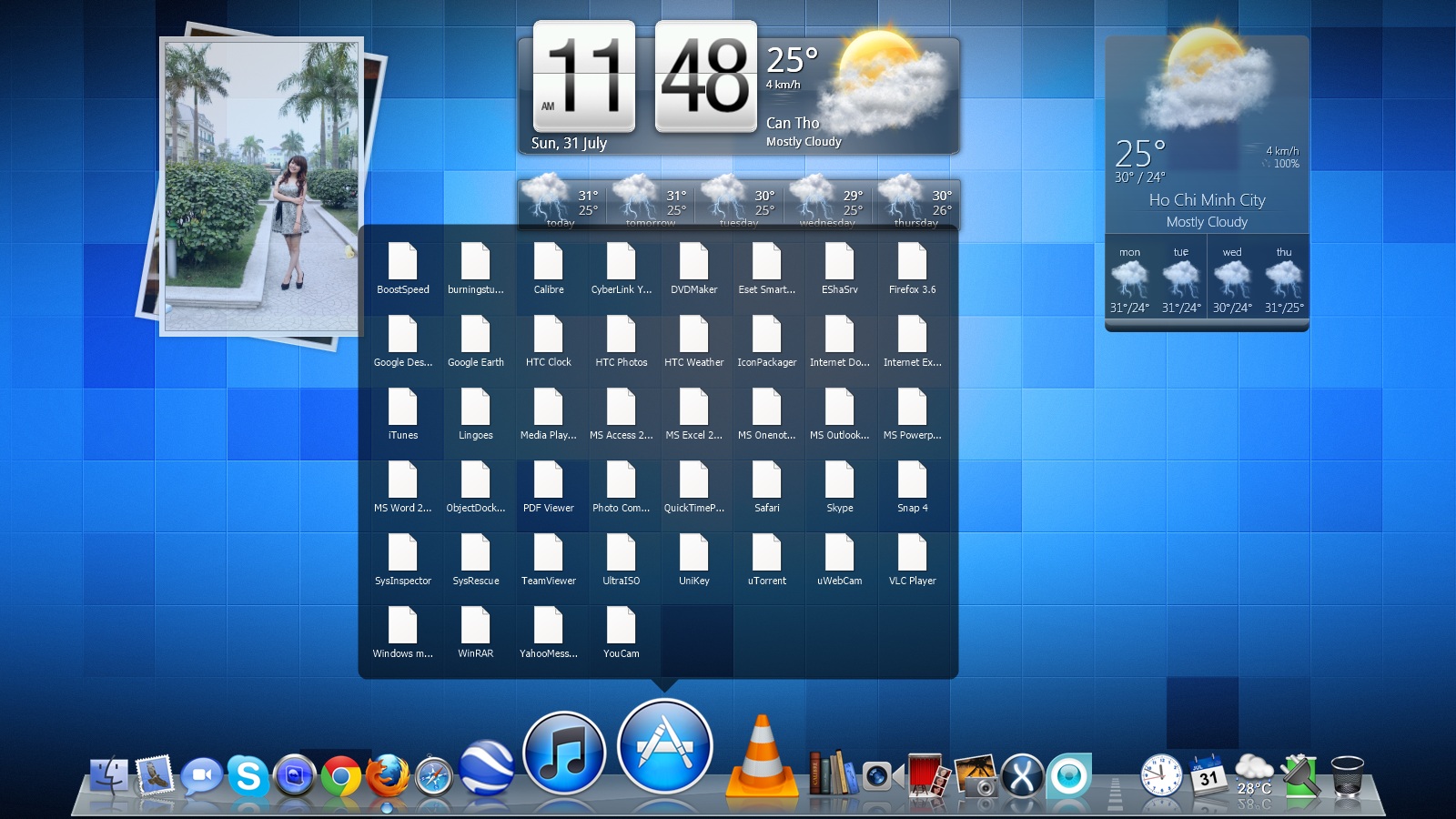

i have a prolem with my Stacks docklet like this (not show shortcut icons)
Please help me. Thank you so much!
P/s: i'm using win 7 sp1 64 bit

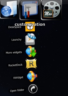

Hi all, I too have had this problem with the white icons. After doing some research and removing apps that I installed after the stack docklet, this is what i was able to figure out:
OS: win7 ultimate sp1 x64
RD: 1.3.5
Stack Docklet: 1.0.0.134 (http://rocketdock.com/addon/docklets/30962) - I also tried http://rocketdock.com/addon/docklets/1791 and http://rocketdock.com/addon/docklets/22757. also tried StacksDocklet2-prebeta-2009-04-02.rar from http://www.matiasmoreno.com.ar/en/Stacks+Docklet+2.0
my problem was Stardocks iconpackager v5. As soon as I uninstalled iconpackager and closed/open RD, I was able to see all the icons in their full color, etc... This happens on all the versions of Stack Dock in RD.
A side note, on SDv2, the change icon opens a windows Open File screen instead of RD icons window. The title when fanned is on top of the icons.
Other than that, I have not had any other issues. Hope that the icon issue can get fixed.
Thanks to all involved, great product.
