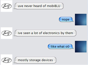

here is a screenshot of the bubbles today (without my 14 font size, I had thought my font size caused the bubble not to be exact but nope its the code or the images being too big.)
to clarify what your seeing it is ZTL's original contrasted to the original ichat.

here is a screenshot comparing the original code(white bubble) to the new code(blue bubble)

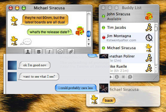

here is another screenshot of the modified code.

they look very nice, I'll start picking away at his code as soon as I get my alpha transparency working on backgrounds with png 24 images, it is being a real pain.
I hit a road block I finally kinda got alpha transparency to work....for png24 for IEView...but since I made the mid top and mid bottom backgrounds that means they go past the rounded corners too...so...the saga continues
.....well it looks like I might just have to start from scratch and recode the entire thing oo
*Update* maybe not, I just wasn't thinking creatively enough, the left and right sides are cells of a table that has one background and one cell background(same cell as text), so I feel pretty stupid right now, duh just make the left and right cells color background match the background color via CSS.
Still can't figure it out cuz the bottom ecorners of the bubbles are backgrounds...transparent bg's are evidently extremely hard to figure out how to do.
I am tempted to just install IE7 beta and see if IEView can work with it, atleast I know IE7 does render png24 correctly. I may end up having to try it, but for people that don't won't to upgrade I dunno what to tell ya. And that is considering if IEView still works. There is a way to install them side by side though so you still have both but which one IEView will choose? I don't know
