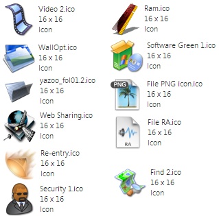

Some clarification is needed on how WinXP displays icon sizes here.
As you all know, a typical Windows ICO file can contain multiple icons, of multiple sizes. However, the arrangement of icons in these ICO files is variable, you can have something like 16x16, 24x24, 32x32, 48x48, and so on. Or, you can have something like 48x48, 16x16, 32x32, 24x24, etc.
To determine the dimensions of the icon as displayed in text under Tiles mode, WinXP picks the FIRST image in the file. That said, to actually draw the icon, WinXP will take the size closest to the one necessary (in Tiles Mode, this is 48x48), and draw that, resizing if necessary.
The distorted icon in my screenshot has all sizes in it, from 16x16 to 128x128 (yes, I edited the INI by hand). XP is displaying the image for the 48x48 icon, despite listing the dimensions of the icon as the first file in the ICO, 16x16.
*Edit: I did some further checking to reassure myself that my theory is correct. I went into an icon editing program and exported the 48x48px versions of both icons. They are also attached. I hope none of this comes as bashing or being annoying - I do plan on having this program replace my current icon editor once this issue is corrected. :)
And an example of non-distorted icons appearing to be 16x16:

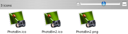

Hi again,
I followed this process: I took a 128x128 PNG and dropped it into AveIconifier2 (most recent release) and dragged the resulting Icon to the desktop.
This was the result:
MIRANDA_osx_update.zip
(My desktop is at 1280x1024 with no modified registry icon settings, with the "use large icons" option checked in the "effects" dialogue under the "appearance" tab of the "Display Properties" (Sorry, I don't know what size this represents.)
Then I dragged the icon into a folder to get this view:
Then I thought I could open the Icon in AveIconBook and move the slider through it's different sizes (am I right to think that by moving the slider, you are able to view the icon's included sizes ie: 16x16, 32x32 etc..?) Unfortunately, AveIconBook's size slider does not tell you the dimensions but here are the images below as they correspond to the slider's position. I hope this helps in anyway.

Indeed, I just did a side by side comparison and a 128x128 ico being shown at 48x48 looks exacly like one converted to that size using aveiconifier.
it looks like nearest-neighbor resampling - meaning it generates aliasing because some pixels aren't considered in the algorithm.
whereas, using photoshop or gimp, I usually resize icons with bicubic or at least bilinear sampling.
Of course, I don't know in any way what these things mean, except that they produce a much smoother result.
