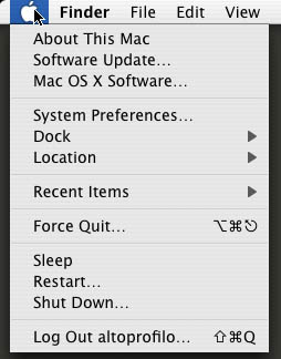

Hey nillinu looks very good! :staffs here:
Why don't use separators?
MENUITEM "", 65535, MFT_SEPARATOR, MFS_ENABLED
...and i think this can help you:
MENUITEM "Sh&ut Down...", 506, MFT_STRING, MFS_ENABLED

Mhm?! I've Panther on PearPc and my menu use separators!

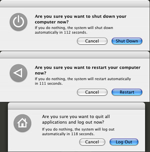

.... and when you click on shutdown, logout or restart, there is a dialog window (look at the image),
so you can use a modded version of msgina.dll and shell32.dll to make the XP dialogs close to the MacOs dialogs!
--> A little suggestion: use "&Log Out %s..." to show the user name after LogOut <--

OK i changed it and I am almost done except for the Recent Items Menu, and Dock Menu, Menuitem Spacing
tell me what you think
