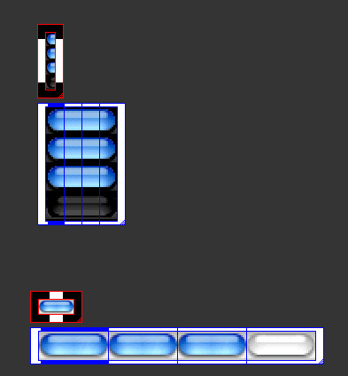

About the horizontal scrollbars, here is your problem, although I don't know enough about StyleBuilder to know how to fix it:
In the pic below, the top is your horizontal bar and the bottom is from TD 4. I've seen another style with the 4 images stacked like yours and the blue guides were running parallet with the images, not perpendicular like yours. As I said, I don't know how to manipulate this but this is obviously the problem.

I'll try that, I don't quite understand your image, but I know what you mean about the image being laid out differently.

It's a combined screenshot from the 2 themes in Stylebuilder showing each theme's horizontal scrollbar image..
If you are using stylebuilder, go to the ThumbBtnHorz properties and change image layout from horizontal to vertical, problem solved. (Y)

OK, fixed the scrollbar.
