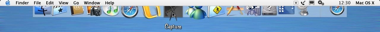

And BTW. how can i avoid this to happen ????
please? :banging:

mad mike thanks dude !! but i need to know how to link to "Dock Setting" ... do you know it ?
and ..... i just want to know, how to avoid my panther OB "taskbar" overlap the Dock when i choose "TOP"..... ???
do you have any idea ?

If you want to open the "Dock Settings" dialog window, just run "ObjectDock.exe" while the Dock is still on your screen.
If you want to have your Dock below ObjectBar, you have to use MobyDock and change the Y-Offset. You can't do it with ObjectDock.
