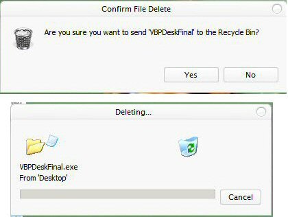

How do I replace the recycle bin animation and icon seen after the delete command. I am using aquaXP mod for windowsXP. You will understand what I mean by looking at the bottom half of the included image.
Thank you

You can replace the AVIs with ResHacker.. I'll let someone else post the details since I haven't used it for a while.
#88036
yeah, use resource hacker.
i checked mine, and it looks like shell32.dll, avi #162-163. go to replace resource, type avi, i think you can leave the language blank, or put 1033, but i don't remember exactly.
or you can use restorator and drag over the avis.
hope that helps.
