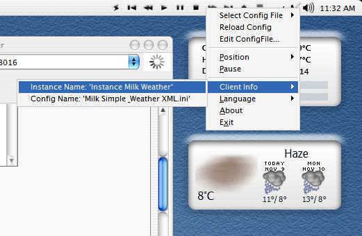

OK, the name of the instance should be the same as in the shortcut that originally calls it, which may defer from the ini filename, to find the correct instance name do the following:
BEFORE the restart script is executed (i.e. exit samurize and double-click on the shortcut that you use to start it) right-click on the systray icon
Then click 'Client Info', the name of the instance to be used in the should be displayed.
Therefore my instance name is 'Milk Weather' (remember to take out the word 'Instance')
