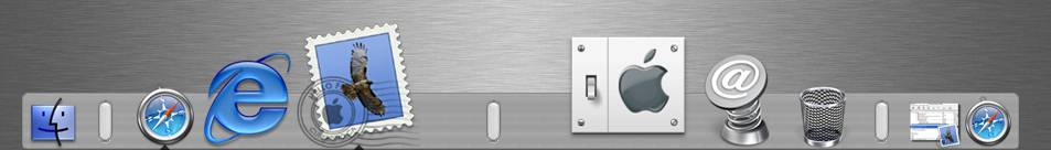

ObjectDock does support having more than one real separator. It's just not documented. You have to manually edit the CurrentTheme.ini to get it done.
Here's how (copied from Max's post)
1. Drag a separator .png to where you want it on the dock (usually
included in backgrounds that have separators).
2. Close OD.
you just placed. It will look something like this:
[item(1-18)]
Type=Shortcut
Target=C:\Program Files\ObjectDock\Backgrounds\tubular-grey\separator.png
Args=
4. Change the type to Separator, delete the target value and title value
so that it looks something like this:
[item(1-18)]
Type=Separator
Target=
Args=
Title=
5. Save the file and open OD. A non-magnifying separator!
I am assuming that this only works with backgrounds that have
separators, haven't tried it on one that didn't come with one.
Cheers.
PS. This should be made a sticky so people don't keep asking for it.

ok, cool, but i did get this tiny error:

I used this and it works very well. This is one of those things I'm sure stardock just didn't want to implement until 1.0 or something so that the list of advantages to 1.0 was that much larger. What I really like about this method is that you can add any image as a separator.

don`t mean to b1tch but separators in OD (or should i say the empty space around them) look too big and not as good as in Yz.
#63812
Yes it's true. But then again, Yz spacing is also narrower than the original Jaguar. Moby has the most accurate spacing but unfortunately works too slow on my systems.

edit: Cool, you can even drag them along the dock and drag them off.

Seems the separator will grow too long when i'm using a dock background scheme with shadow.
Anyone has the same experience?
#63869
Me too :(
I got the same problem with the shadowed backgrounds. I tried to mess with the background.ini files in two ways, each to no avail:
1. I tried to create new separator.png files that were half as tall
2. I changed the settings for Topheight and Bottom height
If anyone has any more info about this or any kinds of workarounds (other than just not using shadowed backgrounds) i'd love to see some more posts!
#66287
I'm afraid it's a bug that hasn't been ironed out yet when shadows are used. Maybe that's why Jeff didn't include an option to add more separators in the configuration settings for this release. I think it has been fixed for the next build and I have a feeling that the option to easily add separators has already been implemented.
Please correct me if I'm wrong JMB. :)

well.... we'll call the user-separator-graphical-glitch-with-shadowed-backgrounds a "glitch" even though you guys weren't supposed to find that whole little "changing-the-item-type-in-the-ini-to-separator" thing in the first place ;):P:rolleyes: hehe
ah, user separators. well, you clever bunch figured out the secret and i won't take it away from you hehe i haven't publically enabled the separators yet because I'm still looking towards the possibility of having a more sophisticated organizational system possibly at some point in the future... at which point the original concept of user-separators might not meld in and screw up the ordering of stuff. Regardless of whether there's a menu item in 1.0 though, I fixed that little graphical glitch with shadowed backgrounds and user-separators ;) Going to go do some thinking about this... has implications more than just at the surface level which is why i shyed away from it before. we'll see.... regardless though that little 'undocumented' trick will continue to work :P hehe
