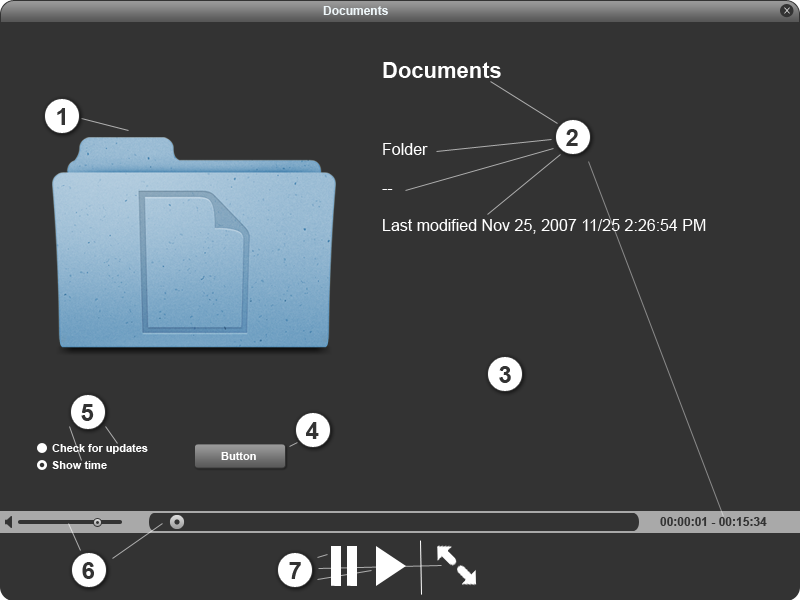

I'm begining developing the Quicklook for windows. Here it's my ideas for design, for available controls for plugins' developers.
On the picture (attach was painted by me :)) you can find following controls/places:
1. Image control - you will be able to add any picture from file's path/HICON/memory/may something else.
2. Text control - just setup text's size, style, color, alignments and etc.
3. The client area, where your (plugin's) controls will have a place.
4. Command button - just a button, I think it will be enough (for the first time) only change its text.
5. Radio/Check boxes - they are the same, but only one thing, radio controls that only one button can be checked.
6. Track bar - may create only two styles (large/small) or may make possible to control height, color of the background, size, gradient colors of the track button.
7. There are buttons you will be able to add your own buttons (but it would be another API, not like for client area, I will think about later).

Example how to create/customize new control - Text and new API (attach is the old one).
// somewhere in the code
QLId qlData->text;
QLFontColor fontColor = 0xffffffff;
QLFontSize fontSize = 24.0f;
QLFontStyle fontStyle = QLFontStyleBold;
QLTextAlignment alignment = QLTextAlignmentCenter;
QLChar text[] = L"Fullscreen is disabled";
qlData->text = QLControlCreate(QLControlText);
QLControlSetProperty(qlData->text, QLPropertyFontColor, &fontColor);
QLControlSetProperty(qlData->text, QLPropertyFontSize, &fontSize);
QLControlSetProperty(qlData->text, QLPropertyFontStyle, &fontStyle);
QLControlSetProperty(qlData->text, QLPropertyTextAlignment, &alignment);
QLControlSetProperty(qlData->text, QLPropertyTextVAlignment, &alignment);
QLControlSetProperty(qlData->text, QLPropertyText, text);
