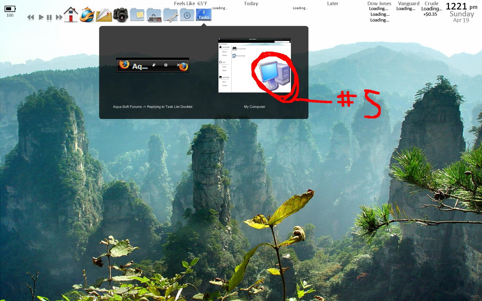

#526833
Never mind #2 I was just being lazy
Here's number five in the attachment.
I'll contact someone from the samurize versions about coming here and getting together with you on making a meter.

@scissorhands7,
I added the options to configure the stack font and color properties. On the issue with the icon, in my system I have installed IconPackager which has helped me replace the default icons used by my system. When doing so, I see no low res icon there, so it must be the icon retrieved from the system.
It has been really hard to retrieve hi-res icons from a running job, if I ever found a way to do it I'll update the docklet, in the mean time I could add an option for preventing the icon from being added to the snapshot... will that do it?
