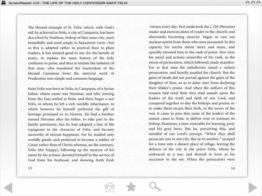

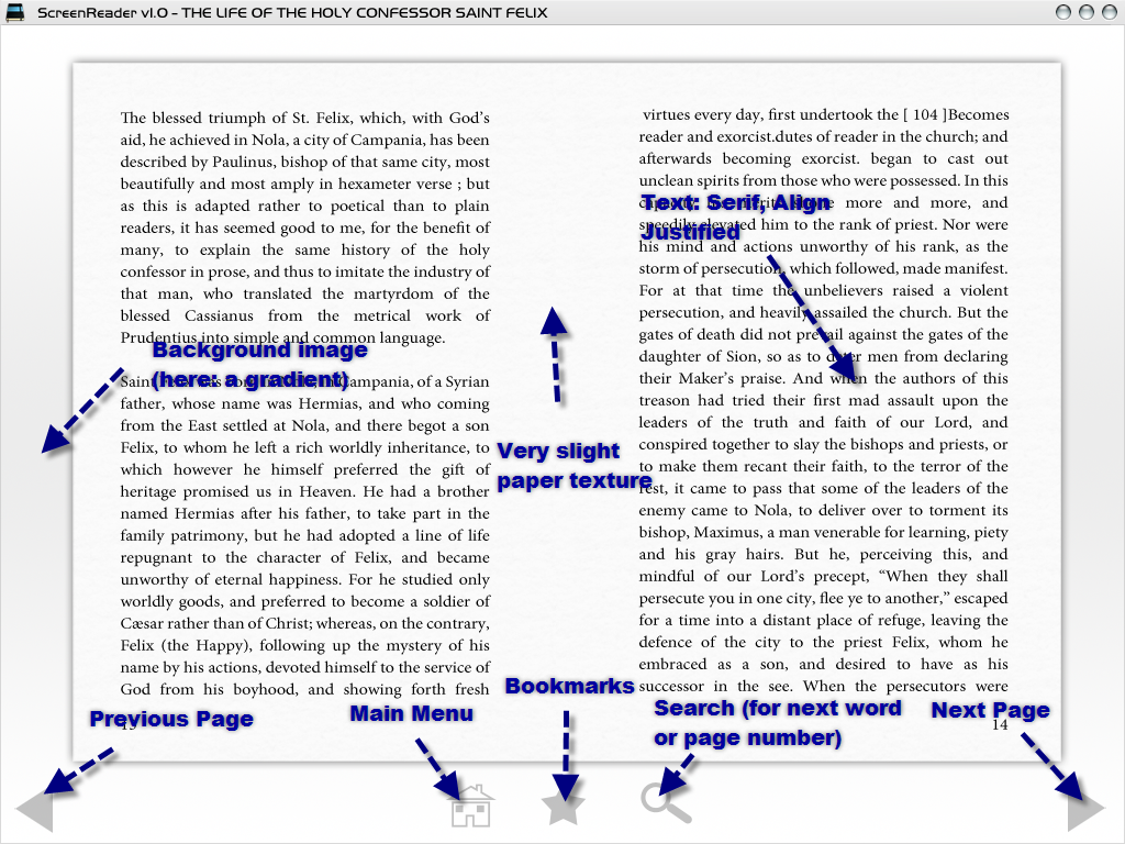

Does anybody know how to draw a String with Alignment = Justify via GDIPlus?
PS: I attached 2 interface-sketches
#524107
I would suggest smaller widgets, and longer lines: around 11-14 words per line is supposed to be the best. Justification is good for eye-candy, but not necessary for ease of use - if you can't do it properly, avoiding vertical trails, just go for left-justified.

I think the sketches are perfect as they are.
Short lines (no more than about 10 words per line) allow for easy speed reading (http://en.wikipedia.org/wiki/Speed_reading).
For justifying text with GDI+ I guess you'll have to use MeasureString for each word and do the spacing manually (yeah, I know: itsucks... plus it breaks precise word interspacing with antialias).
Also, it would be good to incorporate then extra inter-spacing after commas, dots, and other punctuation signs.
I'll see if I can come with a demo this afternoon.
Let's stay tuned.
