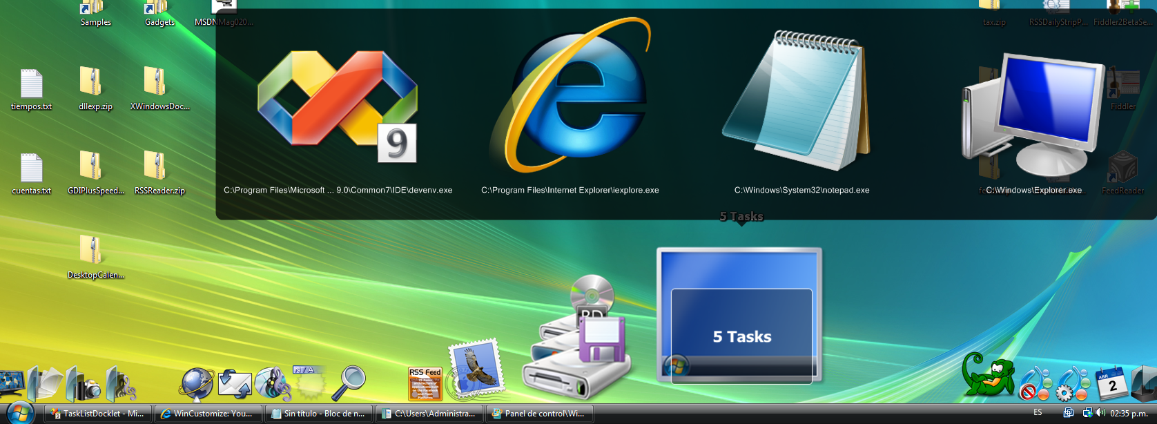

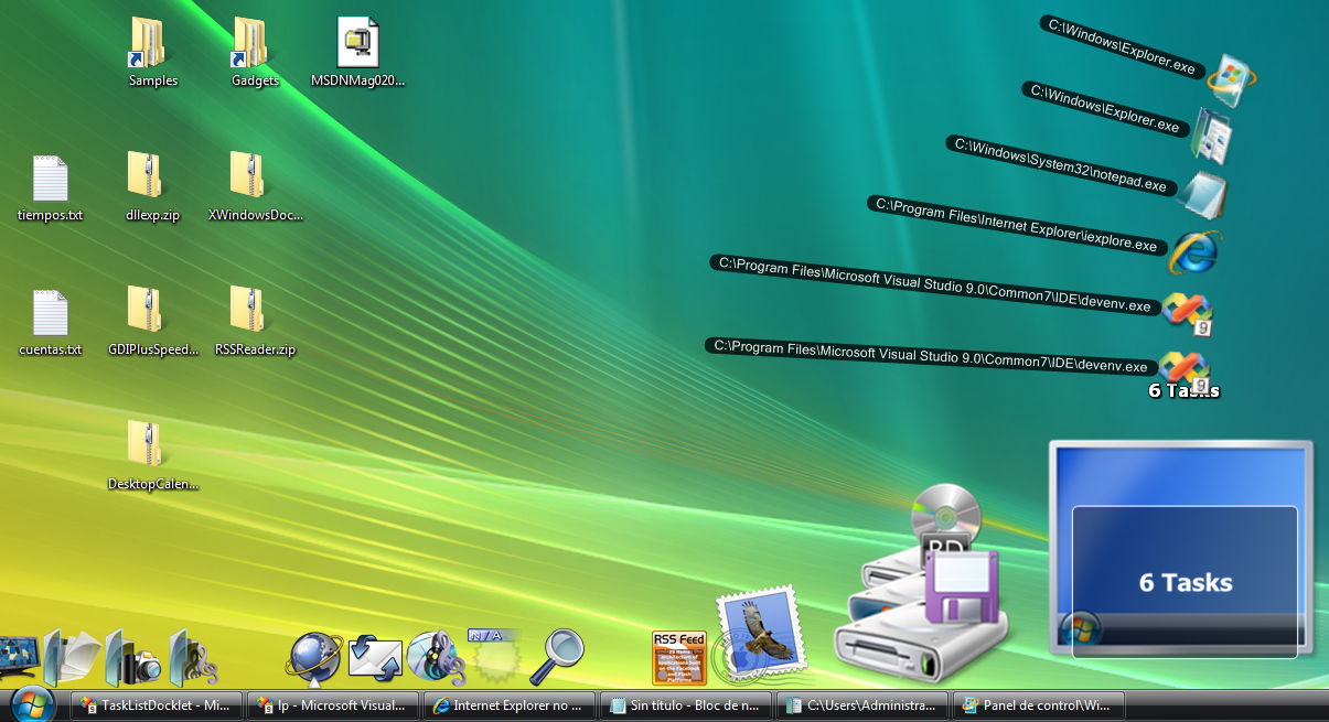

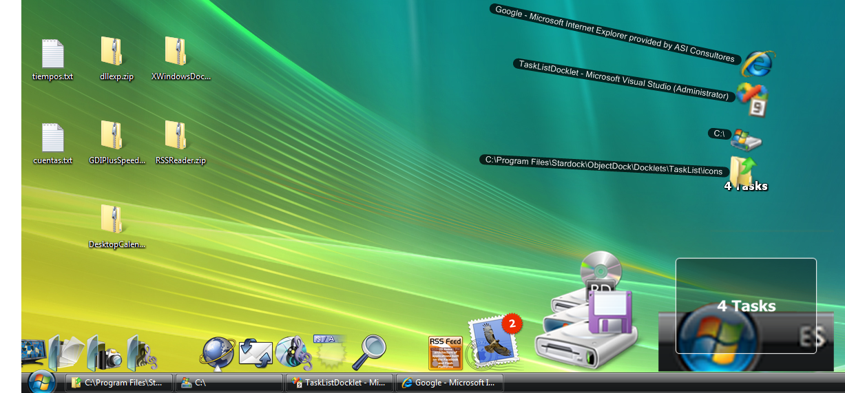

I am creating a task list docklet which will show the currently running tasks... I am able to retrieve the running tasks (those listed in the taskbar) and show them using the stack library. I have included a snapshot just for reference.
I have been following your discussion on extracting icons... although I am having no problem to extract and generate the appropiate icon for each running task, the icons I am retrieving are all low-res ones... how could I retrieve a higher quality icon for the running process. Currently I am doing something like:

The bitmaps correspond to the appropiate application, but they look blurry.

Well I have still found no way to retrieve the appropiate hi-res icon for the running process, but thanks to vantha's help and his XWindowDock docklet I think I found a better way to show the tasks. Now it shows a snapshot of the application among the large icon of it. I have included a couple of snapshots here.
Anyway, there are many possibilities here...
1) To get the hi-res icon, how do you do that in the stacks docklet matonga?
2) To show the snapshot only for not minimized apps.
3) Do as now, show an snapshot of all windows (it cames with a price... performance, it takes some time to do the snapshot of minimized apps).
What do you think?
On the other hand, the docket could be much enhanced by adding some features to the stacklib:
1) Highlight of the current hovered item in the grid/fan (Matonga, I believe you might be working on that, if not that would be an excellent feature).
2) left-button click support so I would be able to add a context menu to say, show, hide, close, etc. the currently selected task.
3) Enable/disable state, that dimms (alpha channel) some item, this could help show minimized windows by dimming the a bit (this would be helpful for other scenarios like the RSS Feed docklet, so I could show items already read as dimmed).
Well... i think that's for now.

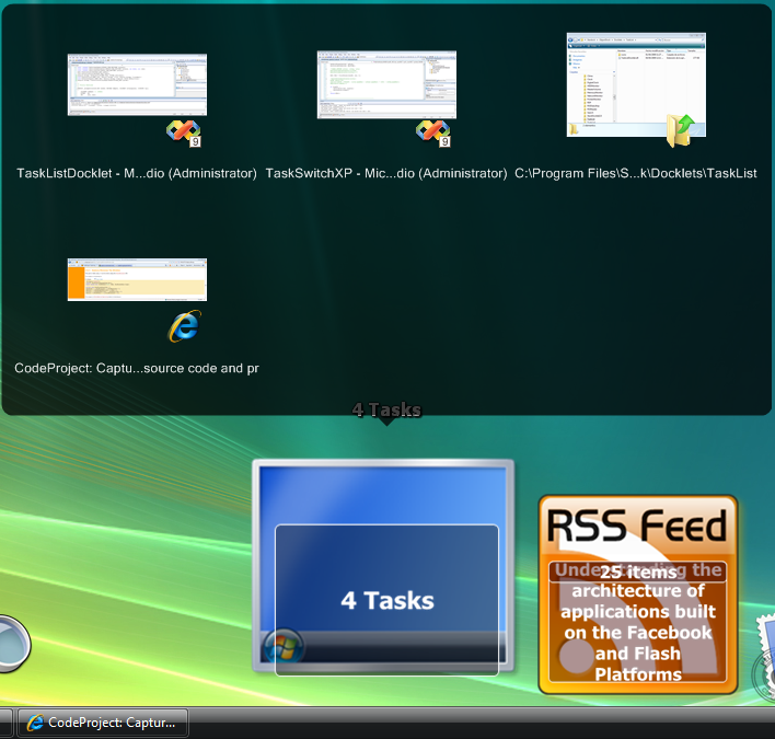

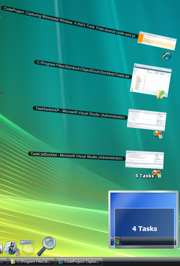

I think a thread for the TaskLisk Docklet (+ Stackslib)... or maybe TaskStacks Docklet is worth... I just wanted to have some developer feedback before posting a preview:
1. Taking snapshots of minimized apps takes time (I have tested it and it might take up to four seconds to get the task list if many windows are minimized.
2. Taking snapshots of only the normal windows (shown) is much faster (since it would not require to do all the transparent-show-minimize stuff needed to generate the snapshot) but it yields those windows without a nice icon... I could use a generic icon combined with the large app icon for those.
3. As in snapshot 2, the hi-res vista icon looks great to... problem is that I have not found a reliable way to retrieve the proper icon.
