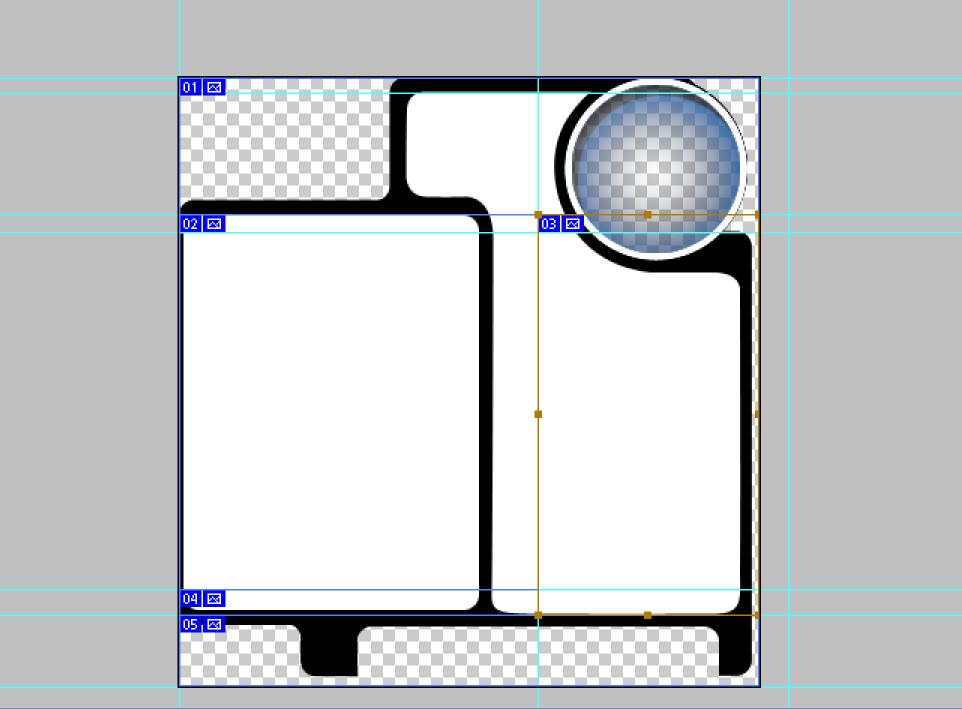

The first image is of a basic start panel I designed

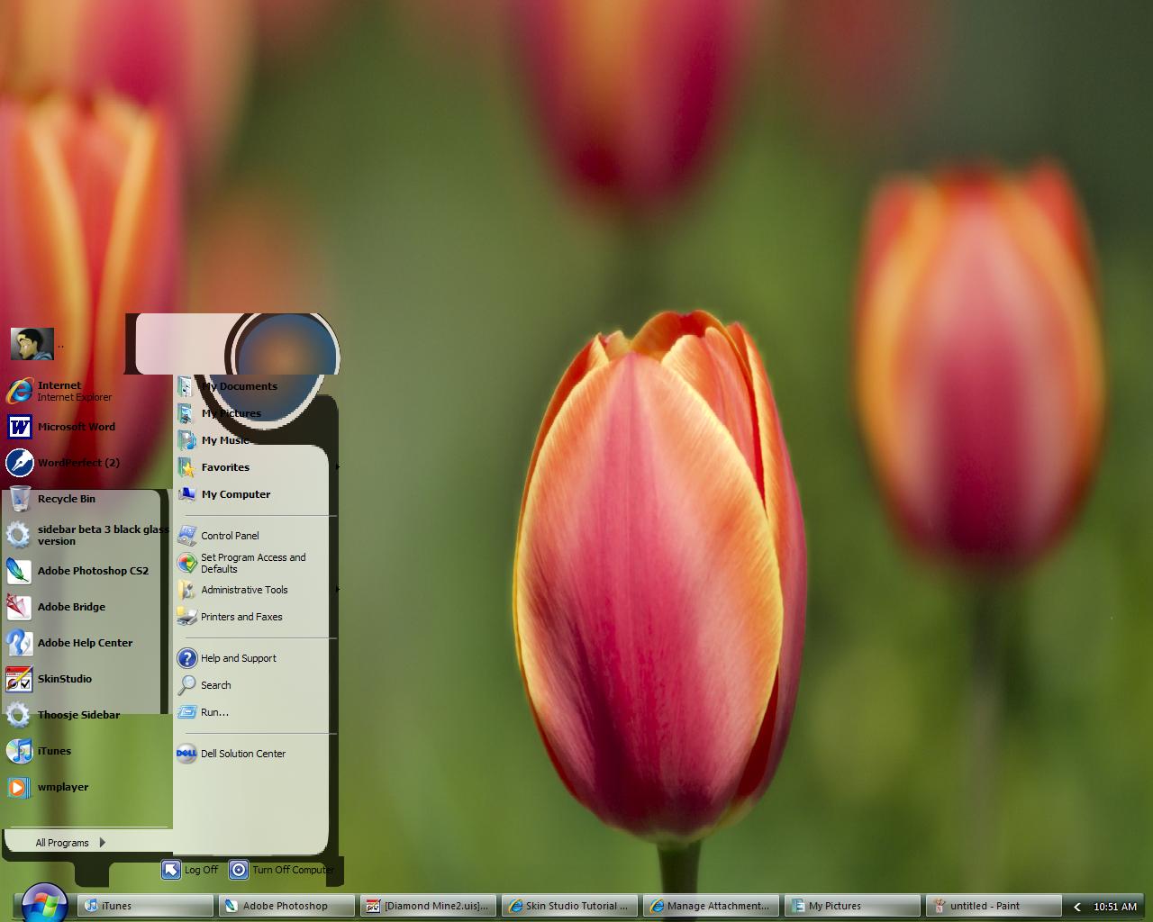

The next image is how it looks after I imported into skinstudio, tried a number of configurations and applied it. Honestly, this program is not for beginners, nor do any to the tutorials explain things as if to someone who's never used it before.

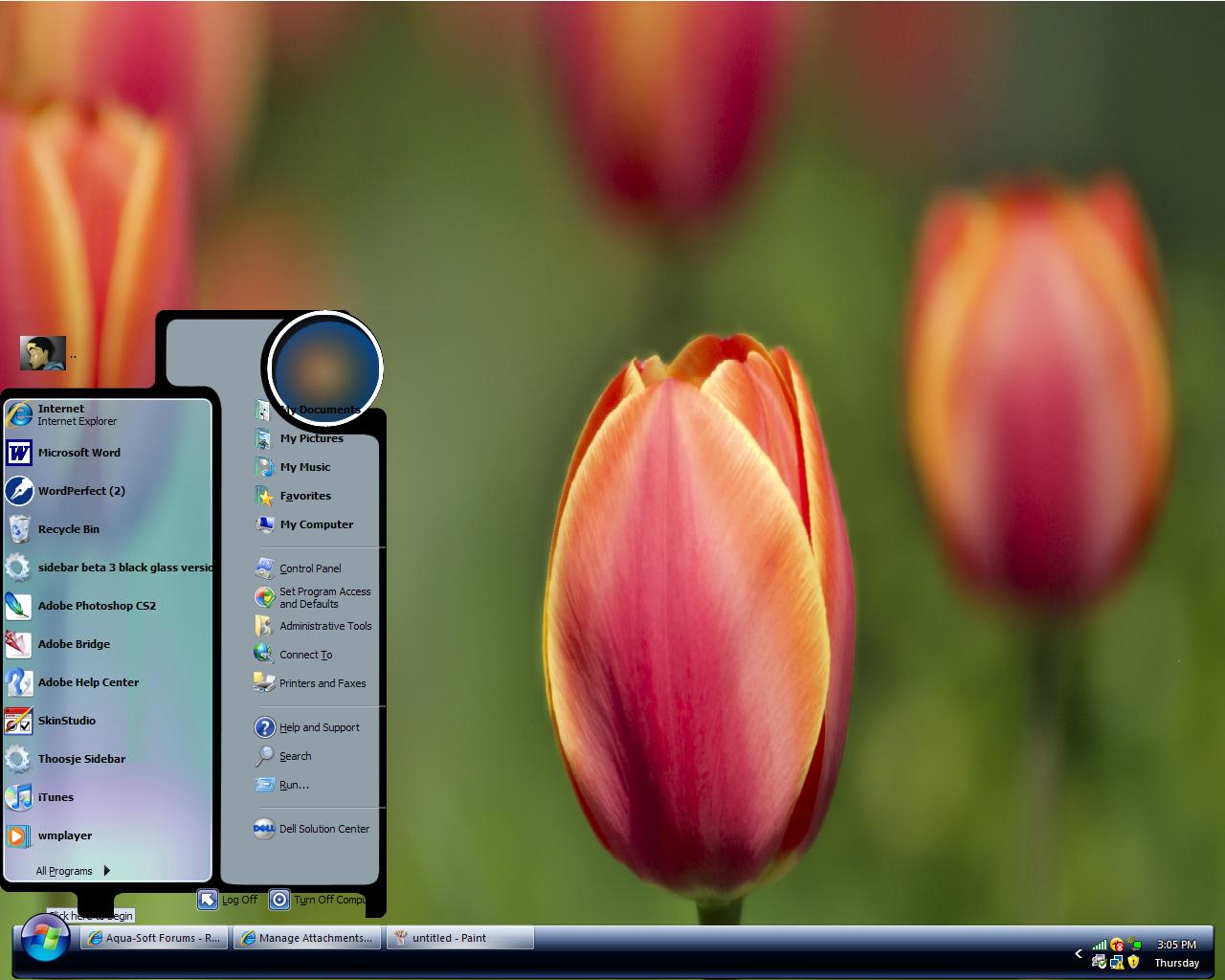

I got the start panel to finally work, but it was all just guessing ( which I dont want to do.) There must be some set reliable formula for skinning successfully. I refuse to believe that everyone who uses Skinstudio either simply copies the "Extras" details of some previously existing Visual style OR just wastes HOURS guessing at which margins, etc. to use for the pieces to fit. Anyway, here is my basic start panel after hours of guess work. As you can see tho, the shut down and Log off buttons are cut off by the start panel. So Im still not happy with it. But this is the closest that I can get it to fit. Talk about frustrating!

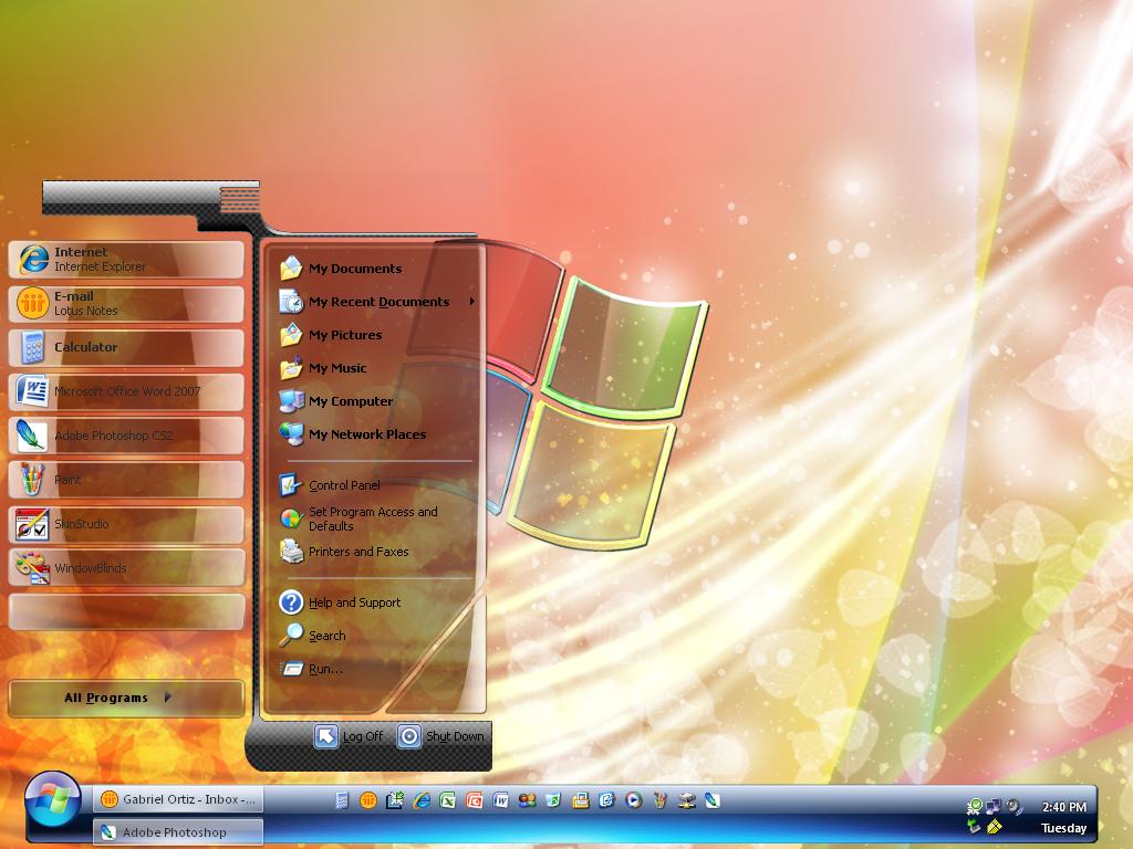

First off, thanks to everyone who've been gracious enough to walk me thru some of Skinstudios features. Here's what I have done so far on my Visual Style

cool. i love everything except that grey thing on top of the start menu. but of course i understant it's still in beta.
