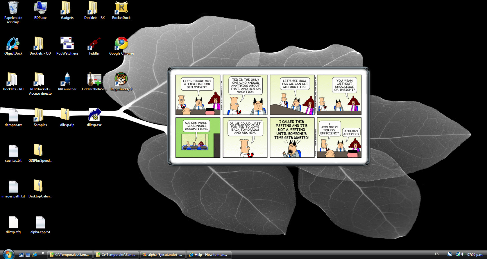

Yes! That was it! It was just a single line needed:
GpGraphics->SetCompositingMode (CompositingModeSourceCopy);
and voila! The comic strip is on it's way!
Thanks so much... I now will review your other comments... specially the tip for laying out child controls.
There's so much I would like to do next, like adding some kind of animation to show the strip comming out of the docklet... but, hey! thanks... I really, really aprreciate your help.
