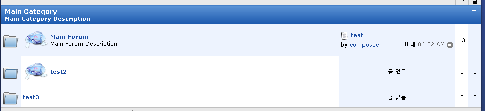

when i was installed this mod..
subforum form wrong working..
and brake subforum form.. [attached images]
so i want to add only $forum[forumhomeicon] code in default aqua-skin v4 in forumhome_forumbit_level1_post and forumhome_forumbit_level2_post .
where can i put $forum[forumhomeicon] this code in?
thanks ; )

Yea, that mod was not made for vb3.5 final let alone 3.7
Use the following...
<tbody>
<tr <if condition="$forum['displayorder'] % 2 == 0">class="alt1"<else />class="alt2"</if> align="center">
<td colspan="2" align="$stylevar[left]" id="f$forum[forumid]">
<table cellpadding="0" cellspacing="0" border="0" width="100%">
<tr>
<td valign="top"><img src="../../unavailable.html" alt="" border="0" id="forum_statusicon_$forum[forumid]" /></td>
<td><img src="../../unavailable.html" alt="" width="9" height="1" border="0" /></td>
<td style="padding-right:4px">$forum[forumhomeicon]</td>
<td width="100%">
<if condition="$vboptions['externalrss']"><a style="float:right;margin-top:8px;" href="../../unavailable.html"><img class="inlineimg" src="../../unavailable.html" alt="Feed Icon" title="Subscribe to $forum[title]'s RSS Feed" /></a></if>
<div><a href="../../unavailable.html" style="font-size:12px;"><strong>$forum[title]</strong></a> <if condition="$show['browsers']"><span class="smallfont">(<phrase 1="$forum[browsers]">$vbphrase[x_viewing]</phrase>)</span></if></div>
<if condition="$show['forumdescription']"><div class="smallfont">$forum[description]</div></if>
<if condition="$show['forumsubscription']"><div class="smallfont"><strong><a href="../../unavailable.html" rel="nofollow">$vbphrase[unsubscribe_from_this_forum]</a></strong></div></if>
<if condition="$show['subforums']"><div class="smallfont" style="margin-top:2px;"><strong>$vbphrase[subforums]</strong>: $forum[subforums]</div></if>
</td>
</tr>
</table>
</td>
<td class="bleft">$forum[lastpostinfo]</td>
<td class="bleft">$forum[threadcount]</td>
<td class="bleft">$forum[replycount]</td>
<if condition="$vboptions['showmoderatorcolumn']"><td class="bleft smallfont">$forum[moderators]</td></if>
</tr>
</tbody>
<if condition="$childforumbits">
<tbody>
$childforumbits
</tbody>
</if>
<td valign="top"><img src="../../unavailable.html" border="0" alt="" id="forum_statusicon_$forum[forumid]" /></td>
<td align="$stylevar[left]" id="f$forum[forumid]">
<tr>
<td width="100%">
<div>
</div>
</td>
</tr>
</table>
</td>
</tr>
$childforumbits
That should do the trick.

thanks Timan!
great~ working!
