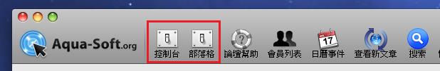

For the top navigation toolbar, I modified "blog_navbar_link" template to this:
$vbphrase[blogs]
But it looks like this:
[ATTACH]12376[/ATTACH]

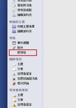

And also, I modified "blog_usercp_nav_link" for navigation menu in usercp like this:
$vbphrase[blogs]
[ATTACH]12377[/ATTACH]

I'm still far from finishing the templates for the blog add-on.
Download the attached zip
Upload the images to your site
Merge the vb_blog_merge.xml into the as4 style (this will add the modified templates to just the blog addon)
Add this to the Main CSS
ul#tb-icons li#tb-blogs a img {
background-image: url(images/as4/misc/blog/toolbar_icons_blog.png);
background-position: 0 0;
background-repeat: no-repeat;
#usercp-nav dl dd a#ucp-blog {
background-image: url(images/as4/misc/blog/ucp_icons_blog.png);
background-position: 20px 0;
That should help, also make sure you have the latest version of the skin (updated today), found out that some of the css was not included.

#506136
Works great!
Thanks, Timan. :)
