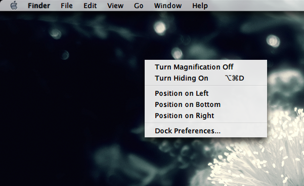

1) See attached image: I have a strange bug where if I click on my Apple icon (I'm using Crni's SmoothStripes theme), I get a floating menu that doesn't go away. It sticks even after I've moved my mouse away from the Apple icon and floats on top of all my other windows, and even if I unload ObjectBar and start it up again, the menu reappears. The only way I've found to make it go away is if I overwrite the .obtheme file in my folder and reload it. This doesn't seem like normal behaviour... is it a problem with OB, or with the theme?

1 CRNI's Smooth Stripes is an old theme, released even before ver 1.65 (i think). you have OB ver2.1 so such bugs sometimes happen. That 'floating menu' is actually a sub-menu of the Dock item in your Apple menu.
If you are familiar with ob customization, i'd suggest you delete that container/sub-menu, then make a new one (just remember what the sub-menu items are, eg. Turn magnification off...etc.).
Otherwise you can try newer themes, there are several 'leopard' themes out there...

Thanks for the help! I haven't been able to find a newer theme that I like as much as this one, but I will keep looking... I've been playing around with OB customisation for a while and am fairly comfortable with the basics of it, but the menus on CRNI's bar are elements called "Advanced popup launcher" which I can't seem to find in the list of available elements. Are they from older versions of OB? Is it possible to get them in this newer version?

Majority of ob themes are configured ala-Mac, that's why the 'Finder, File, Edit etc...' you can rename those items in the main bar as well as make new sub-menus for each, tailor-made for you.
you can also change the skins/colors/fonts of other ob themes to make them look like Smooth Stripes, but without the bugs...

I have the latest version of Objectbar 2.1 and I downloaded some themes that have that bug with the floating bar that does not go away also and I either delete the theme or just right click on the submenu and click hide bar and it goes away but with the same problem when you restart the app or just reboot in general
Any suggestions ?

Don't just hide it. Delete it. then Save. you can then make the exact same menu/sub-menu.
