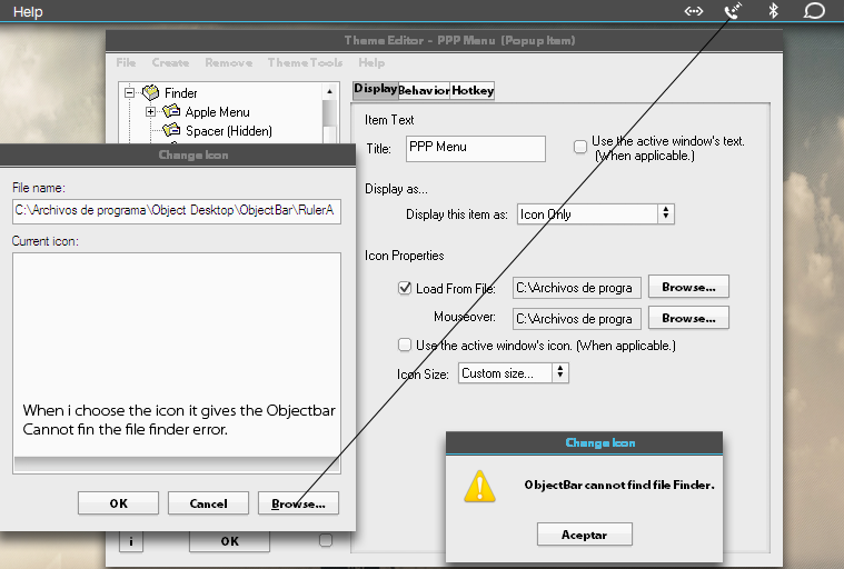

I have seen in some Screenshot normal colorful icons used as tray icons in objectbar, But when i try to change any icon it gives me this error, I'm using Version 1.65.
How can i do this?
How can i do this?
Click aceptor,see what happened
Sounds like you are using objectbar mod?! If yes, close objectbar and start the old objectbar.exe in the install dir. Than u can make your changes. When you finish close ob and use your customized theme with objectbar mod! If you run ob mod every change will affect this finder labeling and you can completley mess up you theme - trust me...^^ I didn't know that too in the begining of using ob ![]()
Hope tat helps
