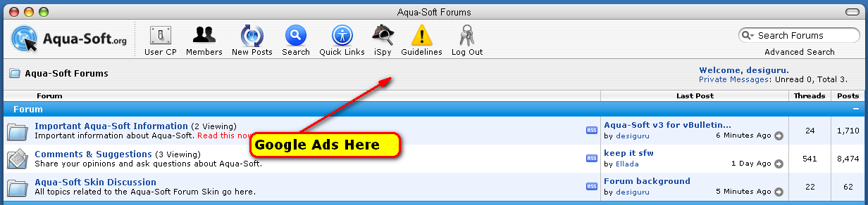

I want to put ads in the aqua-soft skin buit I have never been sucessful. If someone can please show me the actual coding for this ads it would be great.... (Look at the image)

Thats possible to do, you must edit the navbar template, also becareful if you put an ad there, since filling that white space might break the site for lower resolutions.
#438650
Yes it does.... What happens is that the background of that area becomes blues (as the overall background)..... I dont think putting ads on top would work..
Timan, can you please help me add ads after lets say first post or so please. I have tried every single Google Adsense mod on the vbulletin.org but it is just not working out in the vb 3.6.4.

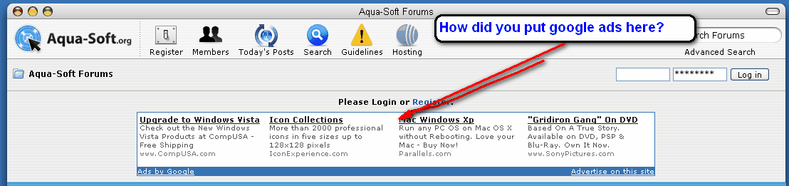

Logout of these forums and go here, http://www.aqua-soft.org/board/index.php take a look at the top, did you want an ad up there like that?
#438667
yea that's exactly what i have been looking for...... in fact today right before i logged in.... i took this picture to ask you that question...
Timan can you please put the whole tutorial on how to put ads like that.

Easy,
<if condition="!$bbuserinfo[userid]">
<div class="pin1 borderbottom" align="center" style="padding: 8px;">
<div align="center" style="padding-bottom:8px;"><b>Please Login or <a href="../../unavailable.html">Register</a>.</b></div>
<!-- Google Script -->
</div>
</if>
That'll show an ad with the propper padding/pinstripe background for GUESTS only... if you want it to show up for everyone, simply remove the tags.
You can put this at the bottom of the Navbar Template.
Navigation / Breadcrumb Templates > navbar
