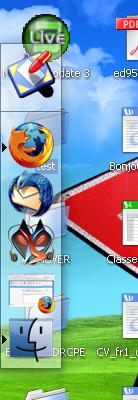

I'm using a dock that is on the left side of my desktop. It's enoying because new icons on the desktop are put from "top left" to "bottom left" so after 6 - 7 icons, they ares placed under the dock and hardly selecable (see screen shot)
Is there a way to make the icons to reoganise the desktop icons from "top right"?? like in OSX

I think Styler might do the trick...

I believe Styler is your best bet. I know this question has been asked before, though...you might want to try searching the forums. Here's a related question:

um yes its styler....plus its free now

Yes styler does right-align but I got a little problem with it because it just apply an offset to the desktop icons which means that when a column is full (on the right) the new icons are placed outside the screen (on the right).
Is there a way to modify this behaviour so that new icons are placed on the left when right align??
