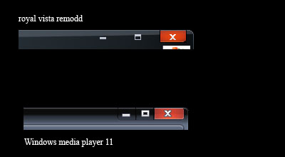

Hi, I am currently remodding royale vista and I have a couple of minor problems.
1. I have an annoying problem with the close-, max- and minbuttons.
If you look at the attached pic you can see that the the WMP 11 close button is much wider than the other buttons. I want to make my skin this way. Although i cant figure out how.

I don't know about #1, but for #2, the only solution that I know of is to use Styler (freeware now) and activate the option for dark themes. It will attempt to to make some text that are always black, white. It's not perfect and is a limitation of Windows XP and its theming engine.
