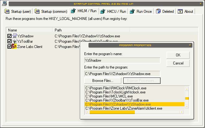

It's much eaiser to get Startup Control Panel (~59 kb), select what you want to startup with windows and disable (or delete) everything else..
Agreed ;)
