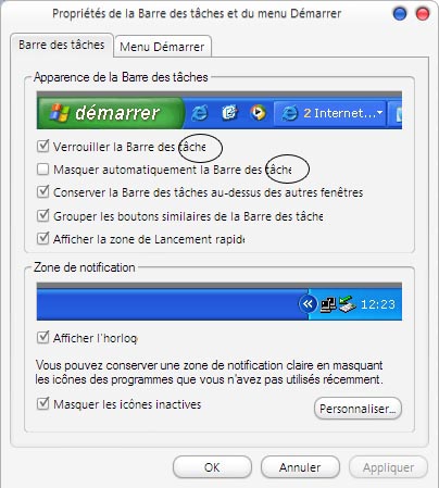

I'm trying to mod the Milky tiger theme for my personal use (remove search icon, change font to Segoe...) and I come up with some text that is truncated at the end of the line. The last caracters seem to be hidden by something...
I've included a screenshot...
I'm using styleBuilder and I can't find the value to change that, changing the font to tahoma or anything else gives the same result!
Anyone has an idea ?

i've seen this on normal styles that havent been modded, they were just made that way :/. but as i don't see it on that many dialogues, i tend to ignore it. this is an interesting question though, and i too am curious about a solution to this problem.

A good question. Somehow we all just accept that dialogues are truncated for whatever reason. I too am also very interested in any possible solutions to this very common problem.

change the font in the vs.
you can also change the default system font easily: http://www.neowin.net/forum/index.php?act=ST&f=34&t=81368

Ok the link to neowin didn't solve the problem but I found the solution :
Under Style builder, the font attributes have to be erased for the values and subvalues of Checkbox and Radiobutton.
That way the default font is used and the text is not truncated.
Hope this wil help...

woooo! omg omg!....this is soo awesome ! i editted the text font in stylebuilder and that didn't work but this works and now my pc's perfect! thankyou guys soo much for this....
