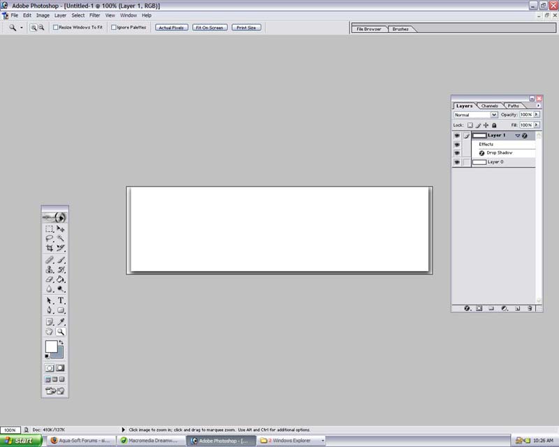

hello nightcrawler1089 thanx again for the reply. I have attached two screen shots one of the file in photoshop the image size is 700px width and 200px high. the second screen shot "2" is how the page is being displayed inside of interntet explorer.
Now here is what i do understand if you download the trial of dreamweaver 2004 they have a halo template I am basically looking at the css for the halo template which i fully understand. I notice that to get the rounded borders on the top of there main div they position and 6x6px image.
So here is what i figure or atleast hope would some how work. I made and image in photoshop with a drop shadow sliced a 6x6px image of the shadow from the left and right side and the positioned just how they have the rounded corners positioned in the halo template. I figure I would then use css to repeat the left and right shadow but it did not work. am I getting close "Slowly Going Crazy"

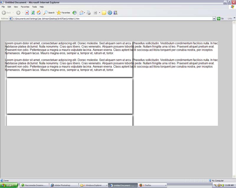

You are somewhat close...you don't have the image repeating at all, however. You need to define a width for the container box so that the text doesn't exceed it, and some padding might also do you good.
#289755
Ok nightcrawler here is another screen and my css code I am repeating the image but it still looks messed up I know how to control other css properties such as the padding but i will focus on the shadow first. I know your supposed to put code you post in some type of format but i cant find that code button anymore so sorry please dont yell. so here it is. I dont think there is anything wrong with it
#container{
position:absolute;
top: 112px;
left: 2%;
right: 2%;
width:700;
background-color: #ffffff;
background-image: url(../TEST.gif);
background-repeat: repeat-y;
so there is the css and the attached image is the result, If you could please check the thread of the above user and his site he has the shadow also it can be done someone knows the secret PLEASE SHARE!!! here is the post DreamGirls@k e n z o its right above my original thread. HELP!!! :(
#289761
1) You need to have your image be 700 px, the width of the #container div, if you want it to look right. (Or have the width of the container div match that of your image)
2) You cannot have a bottom, at least not for this image. You just want the sides--we can add the bottom later, if necessary.

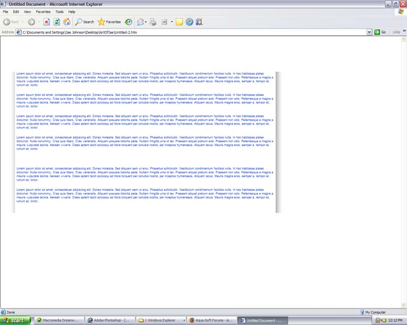

Nightcrawler I almost got it, a couple of things to fix. ok first i made my shadow inside photoshop i made a slice that included the shadow that was 700px in width and 4 px in height i then used css to repeat that as the background of my main container div. I then made a div with enough padding for the content and added some text. I am not to sure if you can see it in the screen shot i attached but the shadow on the right side looks a little bit seperated is there a way to get rid of this maybe make the height 1px instead of 4px. that was the problem why i was getting gaps i was trying to repeat the entire height i had made which was 200px and that did not work. I also made the drop shadow at 72dpi could this cause the little break up?
It seems like i almost have how do i do the bottom really clue less on that, well i will keep trying

#289780
I can't see a thing that's wrong in the screenshot.
I would appreciate if you not double-post: use the Edit button.
The bottom--add another
in the main container and have a background--in this case, just the bottom.
I suggest reading up on a few tutorials around the web. http://www.w3schools.com/ is a good start.
