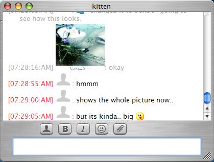

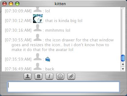

i'm working on making the iChat 2.0 skin show the buddy icon for ppl on AIM/MSN/Yahoo, as the avatar.. have it working, except for a single little problem.. the icon files don't resize.. and most ppl's icons aren't 32x32 which is the size that is really.. use able w/o taking alot of screeen room.. so here is my question.. does anyone know how to make it resize the icon, like the lil icon drawer does?
this is how it looks w/ the 32x32 icon size..
this is the full icon size.
so, as you can see, making the full icon show is just a bit too big.. :-/ lol

is how it shows listing the icon.. any idea on how to change that to force the icon size? lol

the one for my username was the avatars.bmp file that comes w/ iChat 2.0 but i had it sized at 32x32... if you set it to 75x32 you get the rest of the icon.. and i made another one similar to it for my own use. as for the other avatar.. that is a peice of photography called Ophelia Drowns by my good friend Amanda Keeys aka Kittynn, the person i was speaking to, you can see the rest of her work at kittynn.deviantart.com

sry i talkd to dan n he said there is no way to center the text but if ur having problems with the image just change it to
left="0" right="75" top="0" bottom="64"/>
with the 75 being the width and the 64 being the heigth
