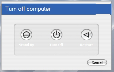

3rd problem ... how to make this dialogue gets back to normal size, cause the image is ugly because now it's bigguer

I am also experiencing problems 1 and 3. I only notice the enlarging pixelated effect with my shutdown dialog, shown below:

the shutdown dialog prob is because of Flykites mod, you'll see its perfectly fine if you dont have a modded system file for that. As for #1 no idea, mine doesn't do that, these might be from the fact that like I said before, I modded Fykites system files to use the proper Real Mac size fonts, which are large, so could be thats causing your probs...best thing to do is mod Flykites files to use the proper fonts and sizes like I specified in the release thread for the skin, you'll find if you do that you wont have those issues, as I already sent my sys file mods to others, and they don't experience any of those issues.
If someone can try on a system that hasn't modded or replaced system files, it'll make things much easier, as Flykite's system mods dramatically effect how windowblinds skins some things, cuz of some dialogs, progressbar, etc that he resized/changed when he did his mods.

If you did NOT mod Flykites sytem files to use LucidaMac, and change its size to 10 in ALL the flykites system files...AND...if you ONLY did the regedit thingy to change the "ms shell dlg" keys in the registry, that is whats causing all the probs with your dialogs, etc.
So if your not planning on modding the files, change those regkeys back to what they were before. But if ya want it to look like the screenie, you HAVE to mod the files as well.

The problem with the logoff dialog box and some of the windows being chopped short is because you have replace some of the default MS dialog fonts. I can't remember which ones those are though >.

MS Shell Dlg = Microsoft Sans Serif
MS Shell Dlg 2 = Tahoma
Edit:
Rebooted and everything got back to normal, problem 1 is no more. :)
