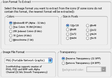

OK here are the 2 settings you need to look out for....
1) firstly make sure that the area you want to be transparent is set to 0 alpha as below.
2) Just export the image as a transparent png...
I hope this helps.
[edit] thanks Applelover
#143215
1) firstly make sure that the area you want to be transparent is set to 255 alpha as below.
Error, set the alpha channel to 0 if you want a transparent background, 255 would make it opaque.
