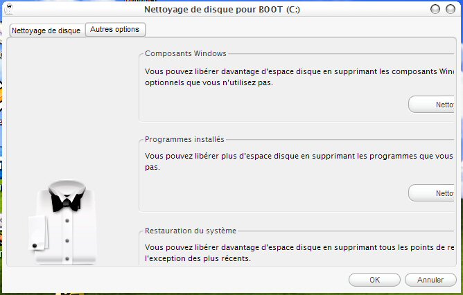

I have a BIG problem, i resiez dialogs for my system files to go with stefanka's one, and dialogs don't appear complete, sse screenshot for more detials ... is this because i changer font from MS Shell Dlg to Lucida Grande, or is another problem ? how could i resize correctly ??

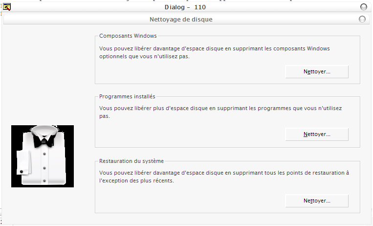

and here is what it should look like
#111161

and sorry, i forgot to upload the screenshot, i fixed it :)

what dialog is that? you might try reshacking it to either resize it or move things around.
do you know what caused it?
#111166
it's cleanmgr (Clean Manager), but this bug appears in lots of dialogs ...
the dialogs have been corretly resized, but the programe don't show only the dialog, it's another window, and i need to resize it ...

Your problem is that you didn't resize the widow dialog but only the tab dialog :P so you have to change the size of the window that contain the tabs and also resize the other tabs (it'll be weird if you do not)
your screenshot is normal, even if you change font size you'll have the text cut and buttons outside window... :)
reset you tab size or change the window size :)
