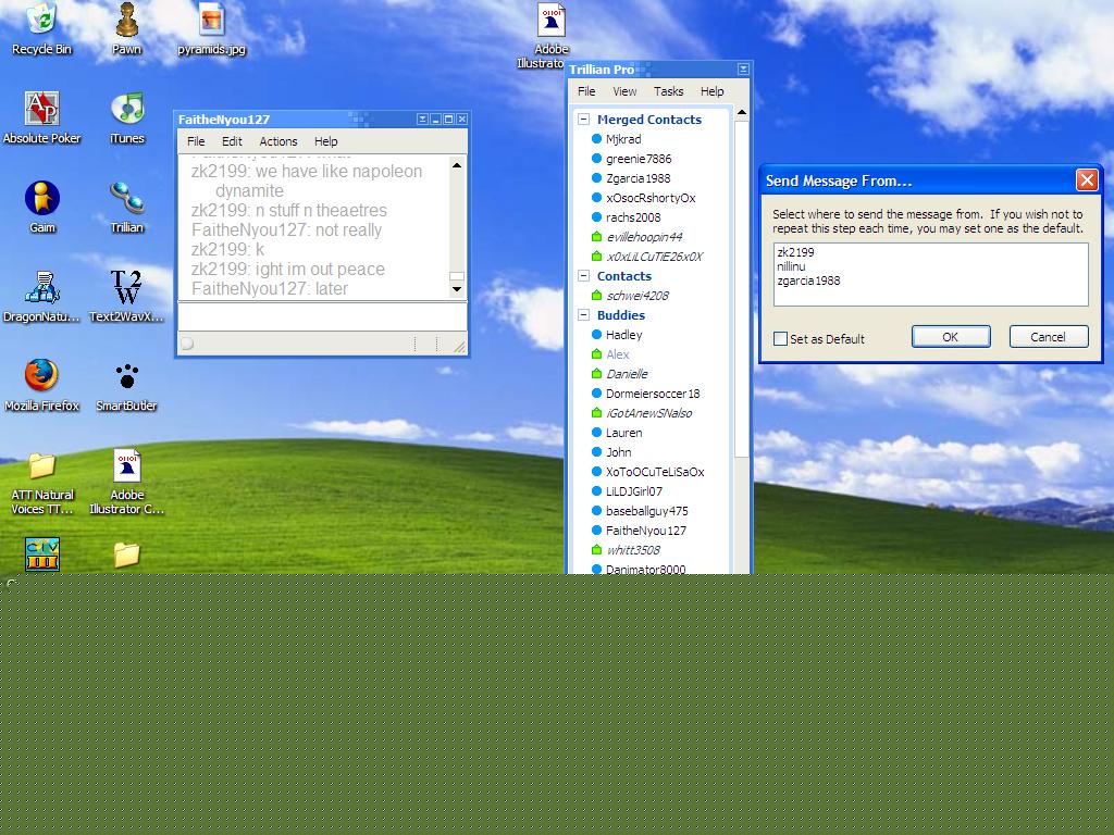

I got it working pretty tight, problem is the
symbols at the end!
arrows
background color
left icons
does anyone knw where i can find the
MENUITEM "&Log Out... xrQ", 402, M
the 402 out of that because if i do i can change the destinations and if it has the icons i believe
also does anyone knw where i can change the arrows
THANKS

Here it is basicly almost done

#16 Guest_nillinu_*
Guest_nillinu_*
  • Guests
Posted 26 July 2004 - 06:28 PM
yes i am getting it from someone and ill post it l8r today (complete list of all numbers)
